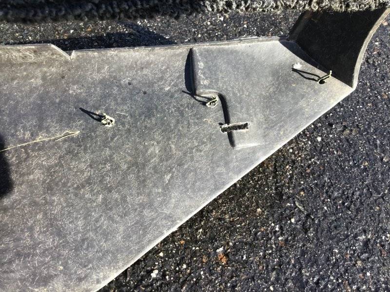

Update: I think my center console did have a front connection point at one time and it was removed for whatever reason.
Flipping it over and in better light it appears the passenger side has been cut down at an angle for about an inch or more and that’s why there isn’t any place on one side to indicate that there would’ve been a bracket but, on the driver side, I can see that there was at least a slot for a bracket at one time.
Anybody have photographs or experience with a center console on what it should look like and how it should attach?

I think the answer is visible if you have access to the center console in question.
If it’s notched on the drivers side like mine is above then the answer is likely yes.
If you have the console out and your floor has the slot on the side of a bracket in front of the hump then - yeah!
My guess is that they did include it on 4 speeds.
