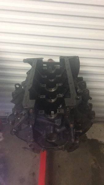

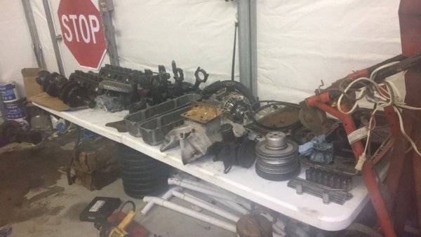

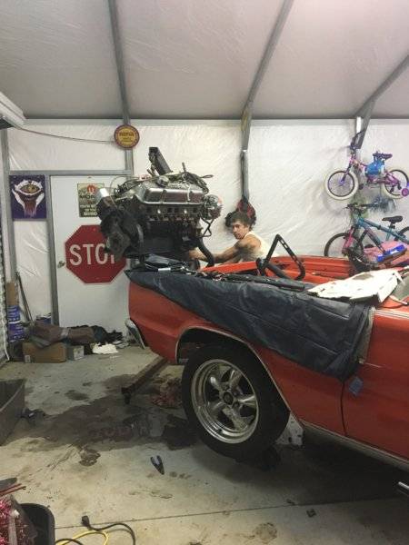

2 years ago I got a 66 charger from my uncle.It sat for 6 years, but I didnt know it had
sat until... A few days later it stopped running. Due to poor time/financial management,
the car has sat for another 2 years. Now that I am in a better situation, the project

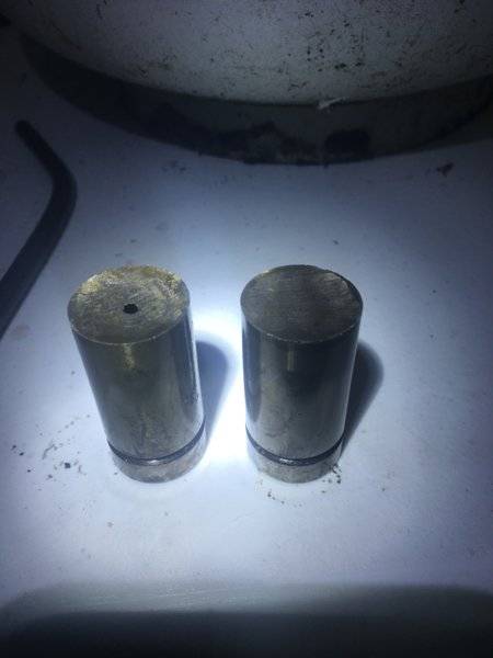

begins. Took apart the engine with my niece 2 weeks ago, wiped cam/rods/lifters.
Total newbie, but I want to learn. Below is my nonconcreted plan, subject to change.
