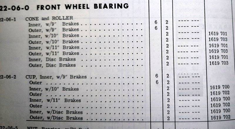

My 1967 Dodge Charger came out with front disc brakes. I can't find any vendor that lists wheel bearing (inner and outer) for disc brakes hubs. They have listings for drum but not disc. Does anyone know where I can purchase the correct bearings? Also, does anyone supply new rotors for this car? Thanks!

Maybe try looking in the parts book for the part number, then google it. I think someone is supplying reproduction rotors, just don’t remember who.
According to my factory parts manuals, all B bodies used the same front wheel bearings for drum and disc brakes for several years including 1967.
Hub & Disc (rotor) is 2823284 (R) 2823285 (L) R vs L thread lug nuts
Depending on size, here is #s for cup & roller. Most likely will supersede to bearing package once you find the correct size.
