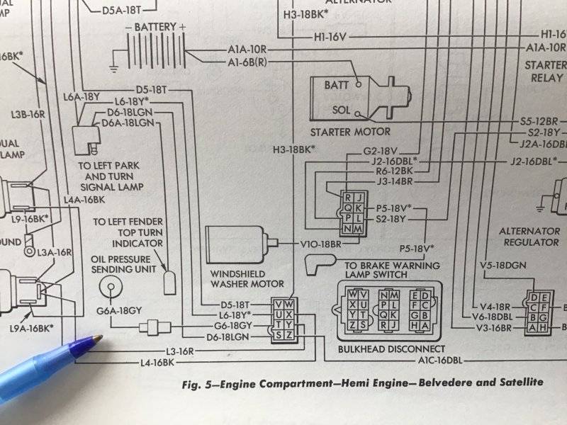

the oil sender is gray to T junction. Is that were it goes? On non hemi Gray with TRACER goes to Tach via J terminal. On HEMI the tach wire does not go through wiring harness bulk head terminal. At least for the 67 Dodge cars.
So not sure if this helps or not, but I would check your gray to terminal T for continuity. Then through bulkhead, then from bulk head to gauge.
If harness wiring is correct you have a break/high resistance somewhere.
Let’s not interchange or confuse 1966 and 1967 wiring, they are different.

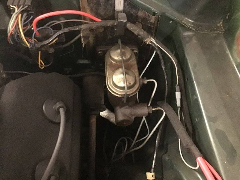

1967 hemi auto has short gray wire coming out of headlamp harness outboard of the master cylinder with a connector that plugs into the battery cable gray wire. it is the wire that is on the far right in the photo.
The hemi engine wiring diagram does not specify auto or 4 speed. And they don’t show or tell you the NSS and oil pressure wiring are both made into the positive battery cable.

After some time with an meter figured out that the gray wire needs a new female plastic clip (Came bare spade) plug and it joins into the mystery gray wire And ureaka the oil pressure light works like a charm
