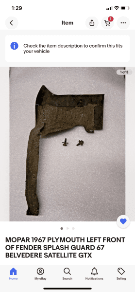

Just finishing up a restoration on a 67 gtx, and having trouble with the passenger side fender well headlight splash/dirt shield. The drivers side was the smaller and fit perfectly with the aftermarket rubber shields( which I was impressed with the Fitment and quality) however my passenger shield that came with the car is longer and does not fit. Were there two designs? One that looks like the smaller drivers side and the longer full shield?
The parts/service manual I have shows the longer...any help would be greatly appreciated. I will post pics of what I have.thank you

67 belvedere front splash shields are a one year item and not shares with 67 dodge line like 65copcar stated. pictures would help

Thanks for reply, here’s some pics, obviously not the same side , the black one is the one that came with the car. I have match to the crusty one and it is the same long style

I wonder if that’s the case, the perplexing thing is my car looks like the lower long rubber shield snaps directly into holes in the fender support as the driver side.
Here is a picture of a drivers side front for a 67 Belvedere any model . As you can see there is no metal down leg. Only metal across top. The rubber strip attaches to it and then directly to the fender. It only attaches with 2 bolts. Not being able to find them I bought some sheet metal from HD. I made a cardboard template cut and shaped the sheet metal drilled the holes and called it good.
