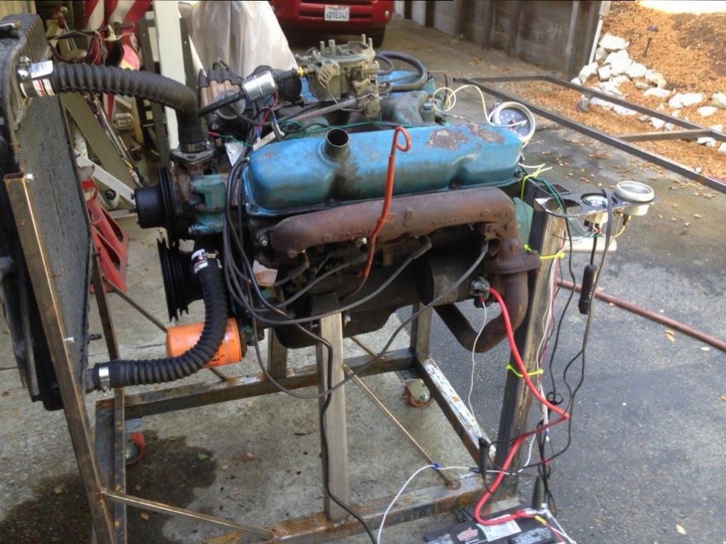

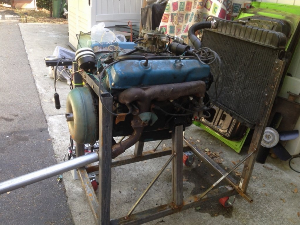

The one thing I did not do is hold the throttle open, so my readings are probably low. Given the compression ratio, I would think the max achievable cylinder pressure would be (9.2-1) * 14.7 psi above ambient atmosphere. Given that, I think it is time to go ahead and start it up. I have it mounted on a homebrew engine cradle - see enclosed fotos. The cradle is pretty rough, but it only something that will serve for a while. If the 383 does fire up and run well, I may consider upgrading it with a mild cam, 4BBL intake/carb, and some headers. It could power the Coronet project once the car is back together.
Somebody straighten my act up!
Top photo...you should NEVER leave the torque converter bolted to the flexplate, if trans is off. Why? Real good chance the weight of the converter will warp the flexplate, making big time vibrations.
Miller,
I thought about that, but the ring gear is welded to the converter. I would have to cut those welds...I can do that, but am squeamish about re-welding it if I choose to use the converter again. Is that something I would be wise to have a trans shop re-weld for me? Assuming I don't go with a new converter....
Just go with a new flexplate when all done.Miller & you are both correct. How can starter crank it over w/o converter? That's a real conundrum(?)
That's why God created flywheels. Should be one somewhere you could borrow.
If you do cut the ring gear loose, how you gunna get the starter to turn that? Hold it against the starter with gloved hands?
Hold it against the starter with gloved hands....man, again, my screen was spared the spray splatter from not having a mouth full of (fill in blank) lol. I've started a lot of engines on stands and on the floor with just a hoist chain for top support and a set of headers for out riggers but I've never even considered firing one up with just the converter bolted on. I don't even know anyone that's done it that way. I guess it may be ok if you don't let it rev any higher than just an idle but even that is going to be around 7 to 800 rpm. If you've ever ran an engine lathe, you know that 800 rpm is booking it especially for something that large in diameter....PLUS, the guts (turbine which isn't small) of the converter may not be aligned very well without the engagement of the input shaft of the transmission...
Gotta think outside the box on that one...just like your run stand. Of course, you do not cut the ring gear off!
But, you DO need to add to your run stand, on a set up like your's. A support fixture should be made, that bolts to the rear of the block (in place of the trans), with a linement coupler for the converter's rear shaft, at least for support. Also need that shaft to be plugged...to keep the fluid in.
Understand the ring gear is needed to fire the thing off. But, as I mentioned, just the loose weight of the converter on the flex plate, can bend, or warp that puppy...just sitting as in your photo.
Just tryin' to give you a head's up.
