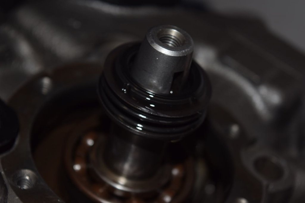

Sat and stared at the original AC compressor shaft seal and read the service manual 4 time will staring at the parts book graphic. I convinced myself I understand how that seal actually mechanically works now so I took the pump apart and reassembled with the seal stacked up like I think it is suppose to. It still leaks really bad. I am not sure if by now it is trashed with all the prying and screwdriver poking I have done to it. I can't find a real picture of the seal stack up and how it installs, just words that say "install x then install y" with no fine detail of which way to install them. Gonna ask around.

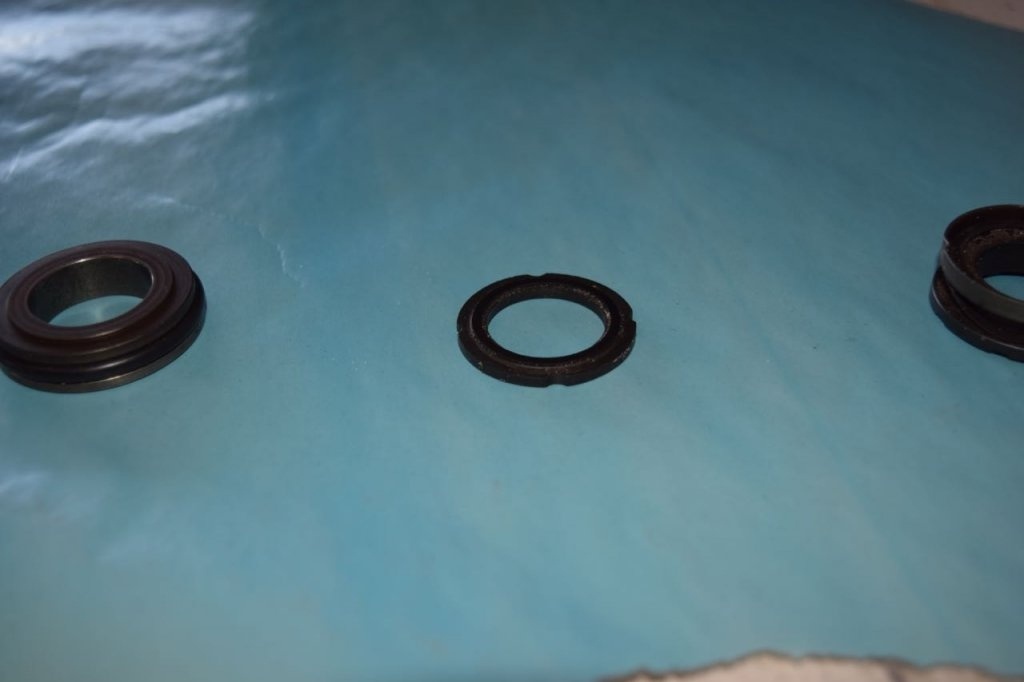

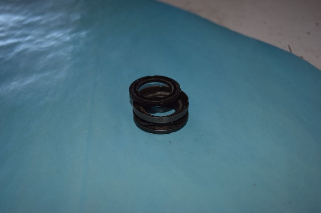

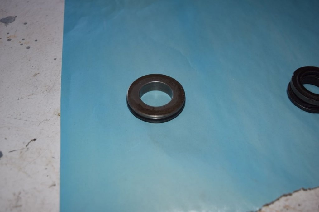

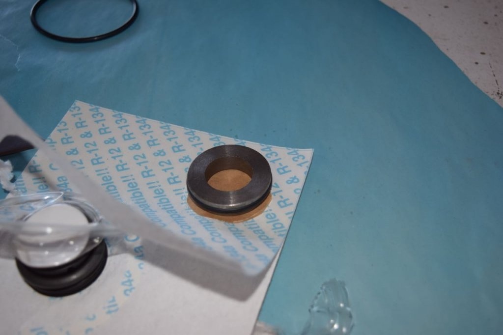

Here is the original seal...

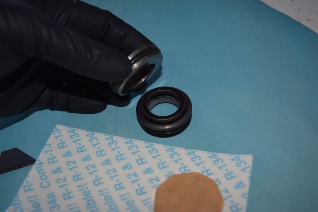

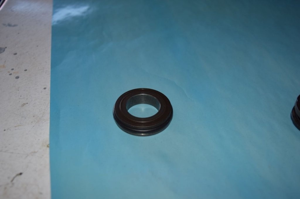

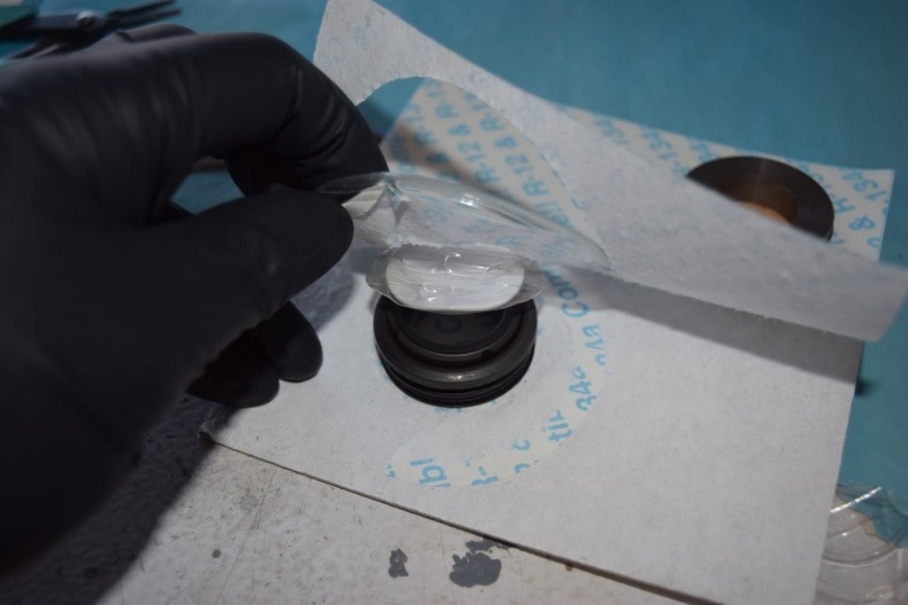

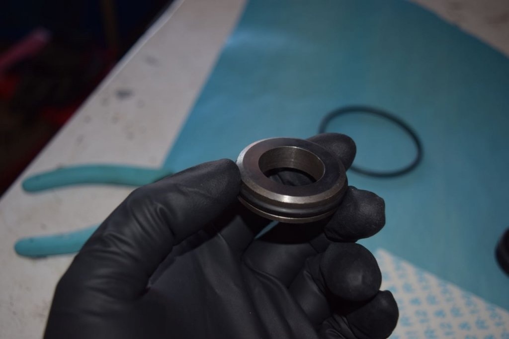

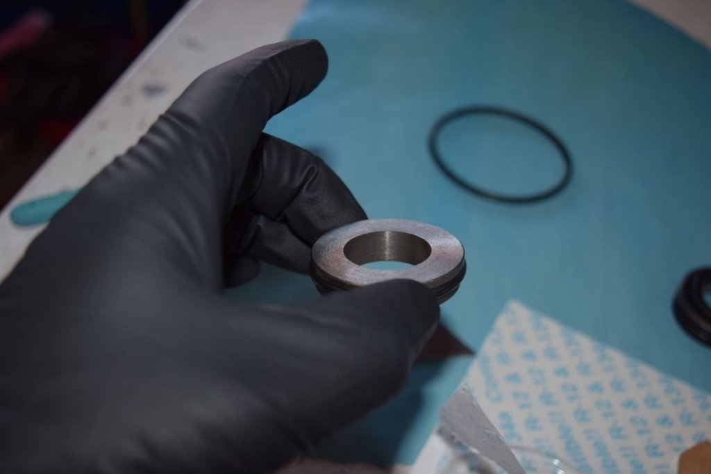

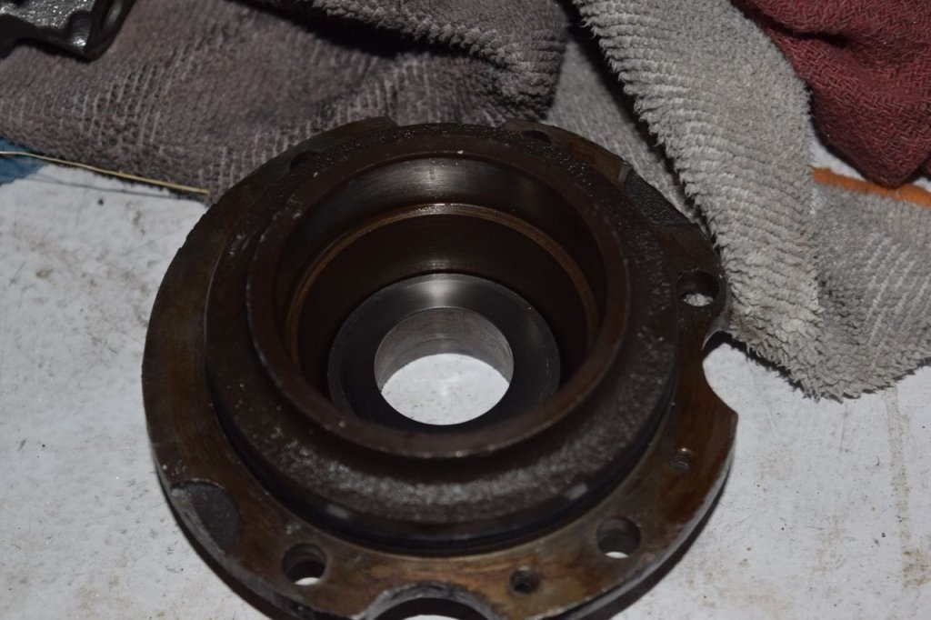

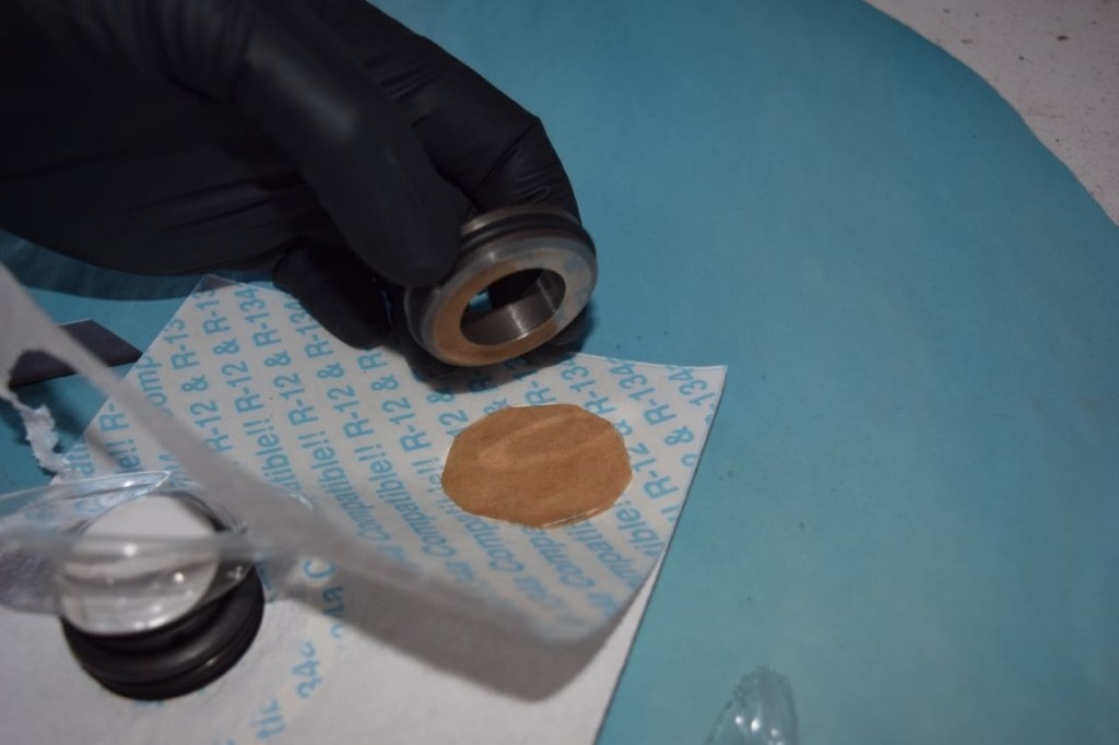

Ok I got it.... First you need to installed the sleeve in the housing. Note that this second seal was different than the first. The first had a raised ridge that is micro finished. This one had the entire surface micro finished and it is obvious since it is shiny.

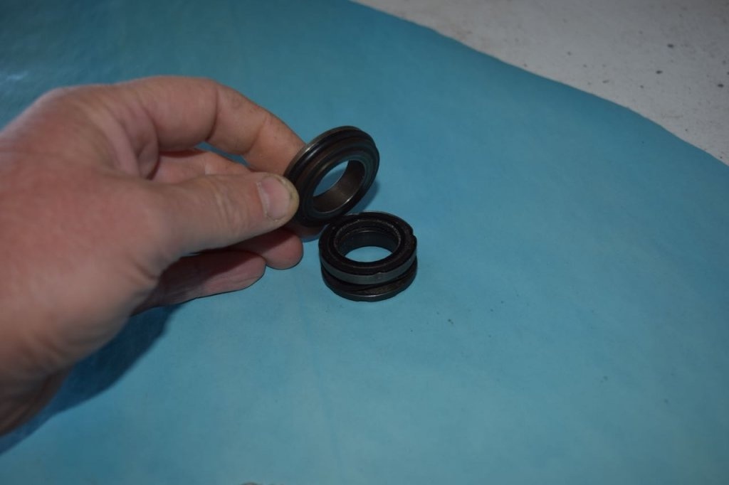

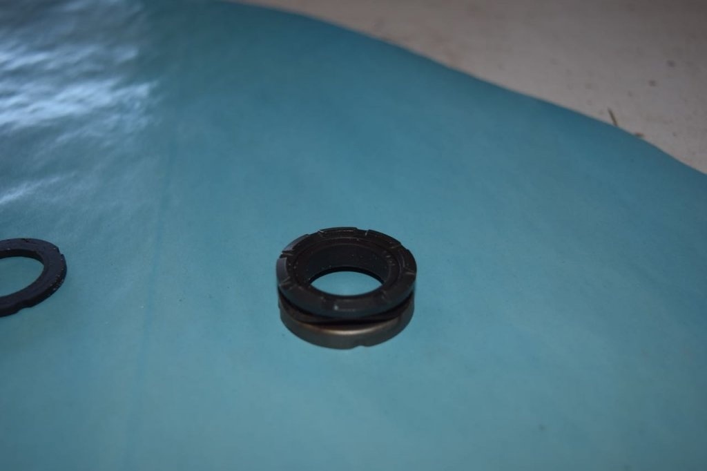

Now the confusing part. Note this is not correct in the photo......and the way the parts are stacked in the package is not correct
If you think about the sealing that need to take place the ridge on the carbon ring (the top part in the photo above) seals against the micro finish so it is in the correct position in the photo. The spring carrier only has one side that the carbon ring will slide down into far enough to engage the tabs into the notches seen in the carbon ring (this is so the ring will not spin in the spring carrier). The "rubber" shaft seal then goes into the spring carrier to the BACK side of the carbon ring presses on the lip of the seal. Now when the cover is bolted on the micro finish plate presses on the carbon ring ridge (seen above) and the spring then pushes back on this plate and presses the lip of the seal against the back of carbon ring. This effectively make an "L" seal.

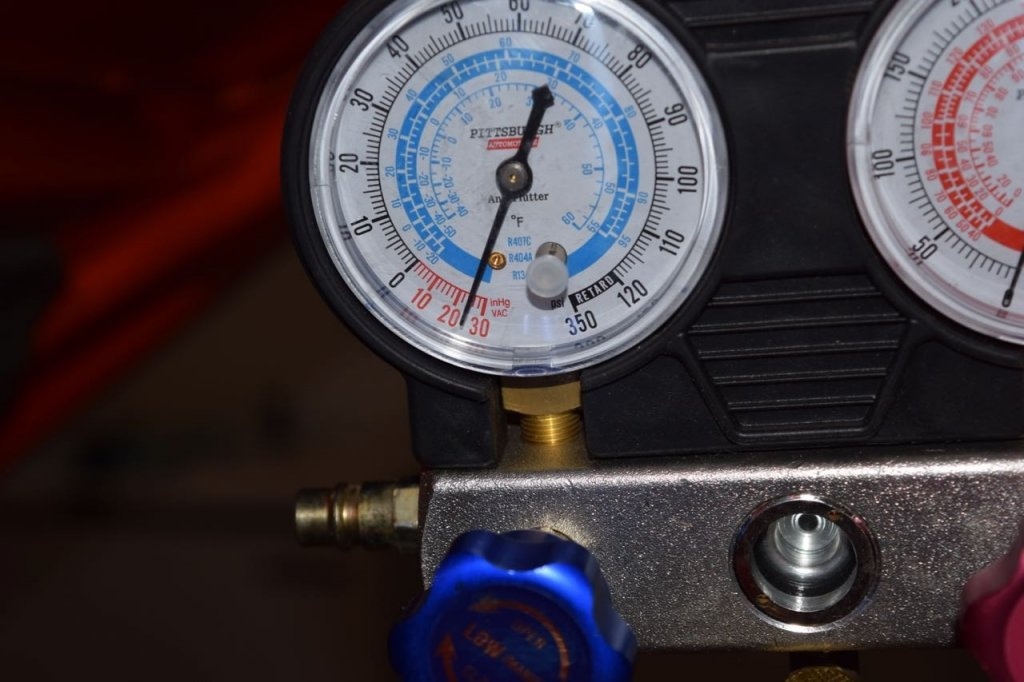

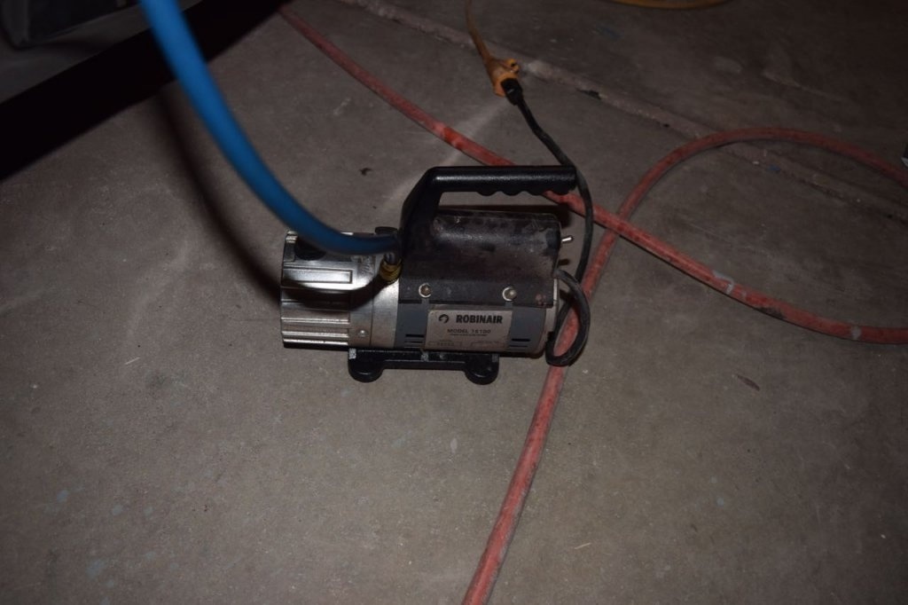

Connected up my 1980's vintage vacuum pump that can still pull 28 inHg!
It pulled the system down to 23 inHg immediately which is a HUGE improvement from the past attempts.
I have it still running but after an hour assembling the compressor it is pulled down to 25 inHg. I will let it run till I go to bed then leave it under vacuum and see what it is in the morning. I have had it open for a LONG time so I need to pull it down for at LONG time to get the moisture out since I don't have the ability to pressurize with dry nitrogen.

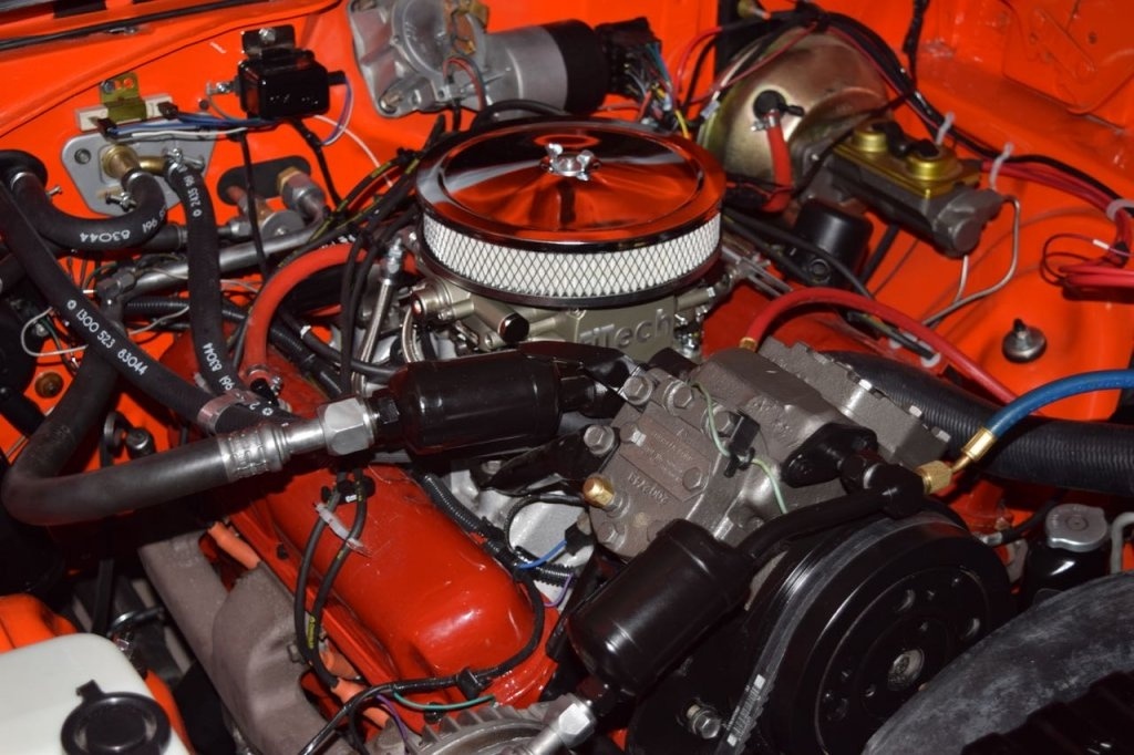

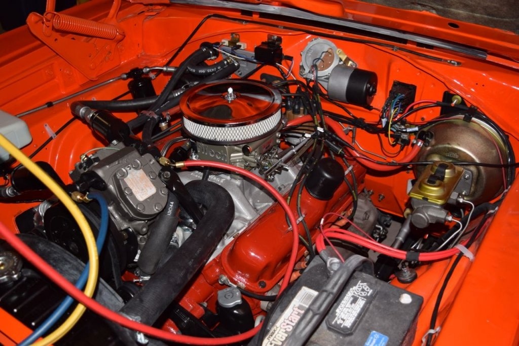

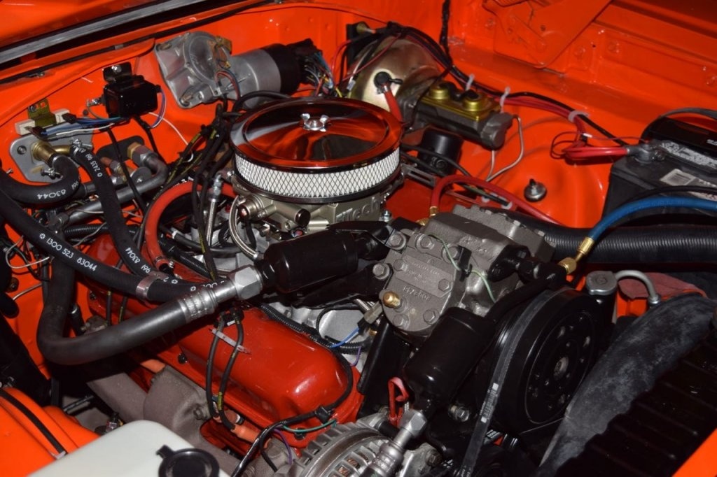

Here is my (interim) completed engine compartment.
