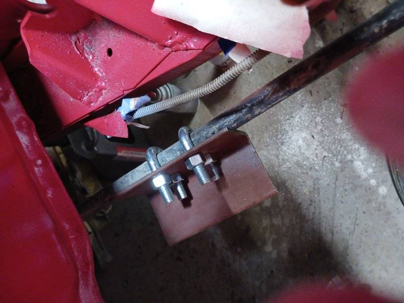

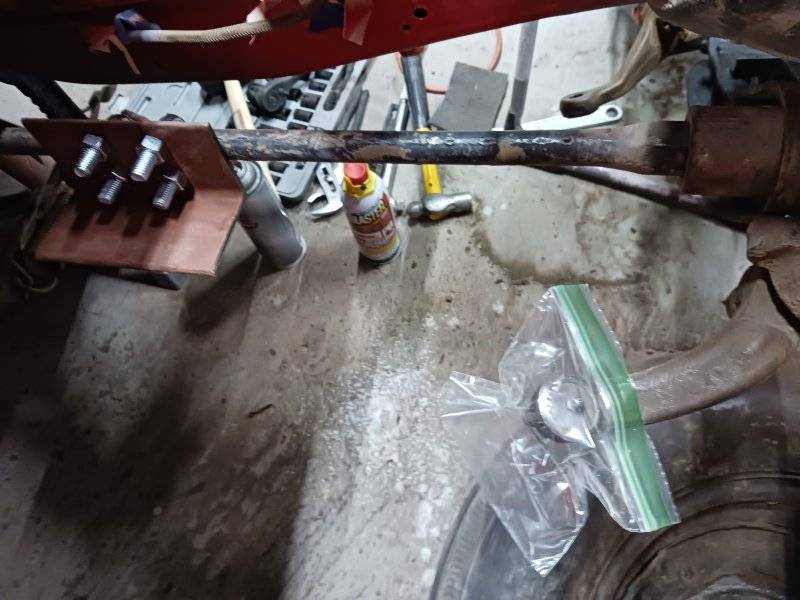

Here's the torsion bar removal tool I made for a few dollars to remove them from my Challenger. A few hits with a hammer on the red angle bar towards the rear and they came right out. I shot some penetrating oil on the front hex socket to aid in removal. Note the tool I made can be rotated around to hit from underneath the car and I hand ground the insides of the U-bolts smooth. I left the LCA pivot shaft bolted into the k-frame so the front hex of the torsion bar came out of the LCA hex socket.

Good thinking. That will work just as good as the actual tool that is sold for the job.
