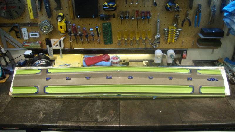

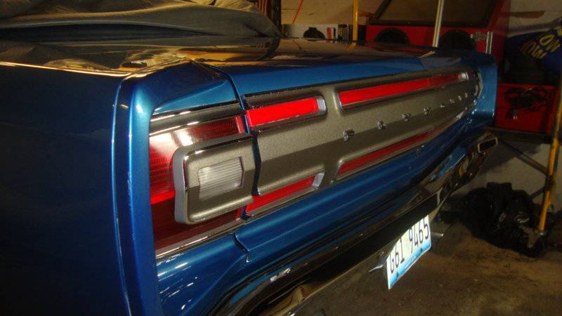

thanks for info I had mine re-chromed now going to try painting it

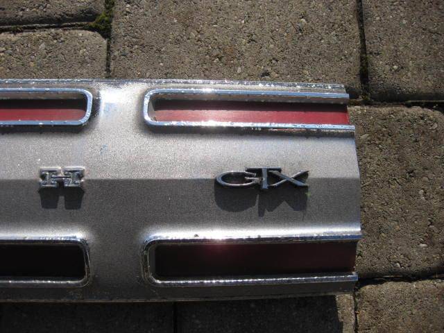

Original Panel:

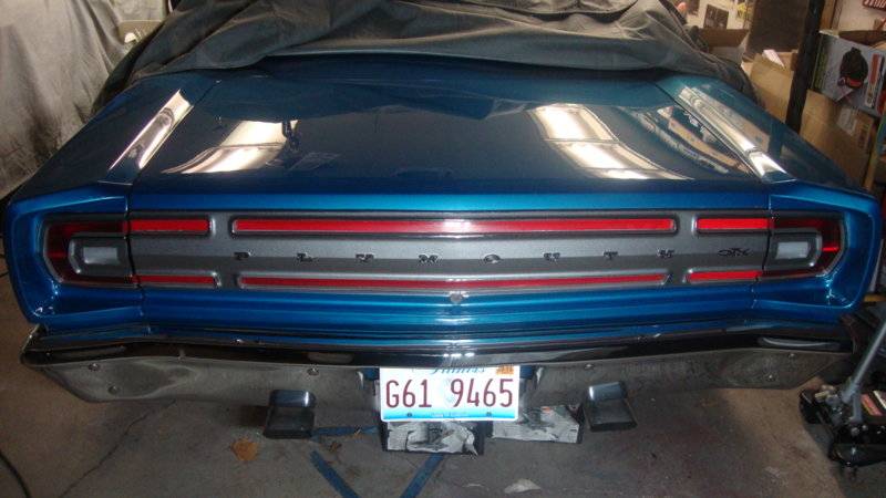

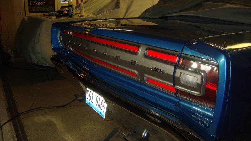

Mine now:
I think Bob got it right. :)

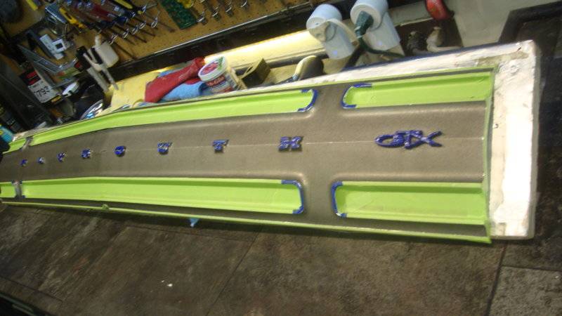

Thanks Justin @moparnation74. I restored mine myself. It was PITA with all the taping and whatnot. It's dark argent and a dark red decal for the stripes. I purchased the panel from a member here and it was already re-chromed. Ill post pics later as I do not have them on my laptop.
Aren't the badges removable and interchangeable?...........................MO
I don’t believe so Mo - mine looks like it’s part of the panel. However I haven't had the panel off so I don’t honestly know. It would make sense that they were interchangeable accept the argent paint wouldn’t line up correctly from a Satellite to a GTX badge.
The emblem looks to be welded on from the back. There are two prongs that go thru the holes and then it looks like there is a dab of weld on the ends of the prongs.
yes I think it is welded or peened
The GTX emblem is indeed a separate piece. They do reproduce them.
Regarding the "shade" of the argent paint, I know several have used the darker argent when restoring their panels.
However, after a LOT of research (including pictures of original, untouched panels like the one I posted above), I came to the same conclusion as some professional shops who have restored these - namely, the lighter argent is correct.
When Bob came up with some leftover, original Chrysler paint in an old can in the back of his shop, he asked me if I wanted him to try and make it usable for my panel - at the risk of delaying things if it turned out badly.
My answer, of course, was "absolutely!"
He nailed it, first try. :)
My "edges" that were originally chrome were not rechromed, however.
He did what he could with those in lieu of that and it turned out just fine.
