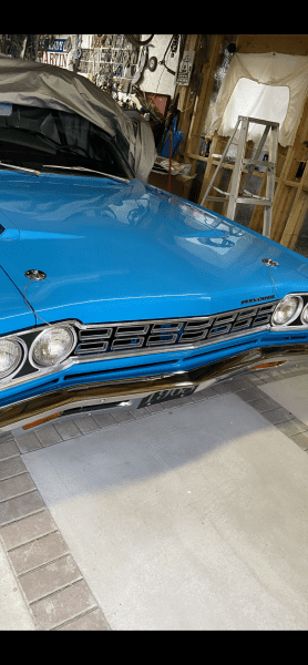

I just found a dealer for the Dark argent paint that goes on a 1968 RR Grill. If anyone would be kind enough to send me some pictures of how the grill is painted with this color I would greatly appreciated it. PS the place That I got this paint from is 8774paint1. He is out of CA and is super helpful!!!!

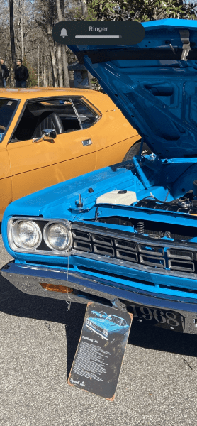

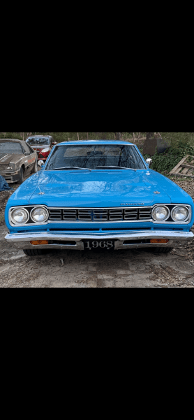

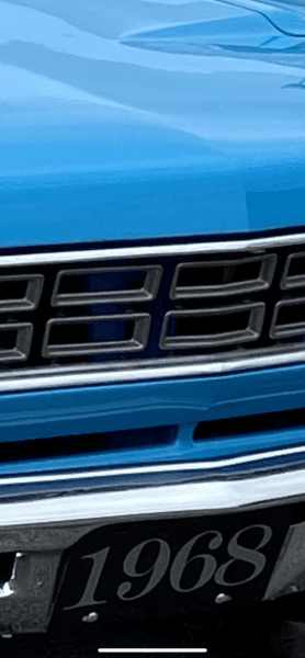

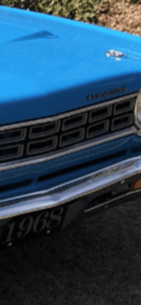

The rectangles got the argent silver and the standoffs were flat black.
Post #13 has a pic, hopefully that helps some...
