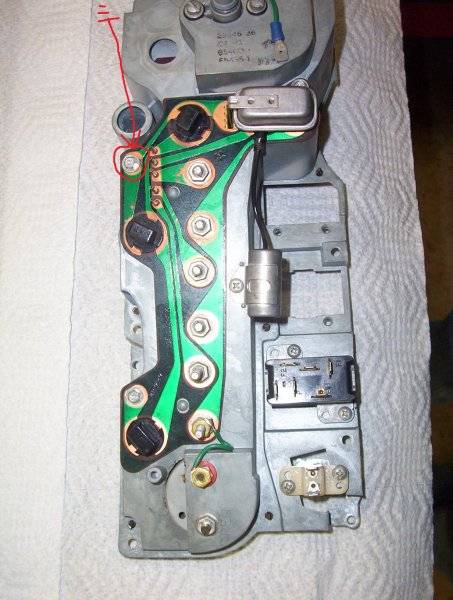

You are losing the ground to the circuit board.
Make a ground with two eye terminals. One to the spot shown in my photo and the other to a clean shinny spot on the dash frame.

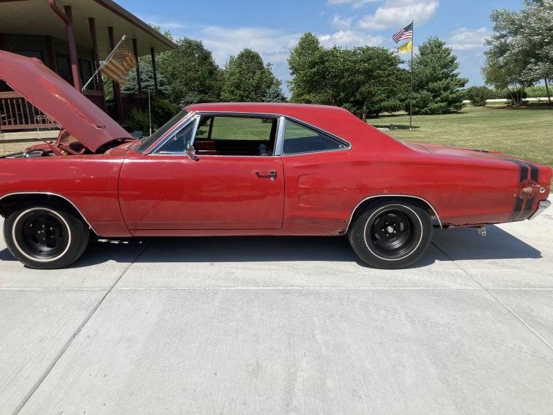

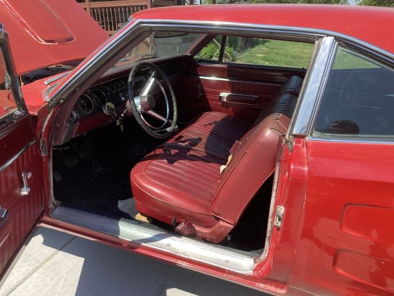

A couple pics of his ‘68 bee.
