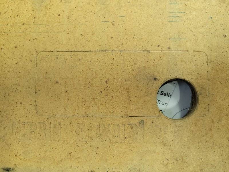

Hey guys just putting my car back together and had a question. Is there a difference between the manual and power window door panel? My car is a power windows car but I never took the car apart and never had the original door panel.
As far as I know there is no difference. Its just the way they are cut out for the crank handle or switch. My replacements had two options cut into the panels backer board. You choose which one to punch/cut out.
PW has square hole, MW has round.
Driver's side has the large, rectangular hole for the 4 switch bank.
You can cut a MW panel for PW switches, but you can't fill a PW panel for MW holes.
Cool thanks for the info guys I’ll check into it alittle better I was looking at some web sites and they only give one option.

I almost said- they should have perforations or guide marks.
