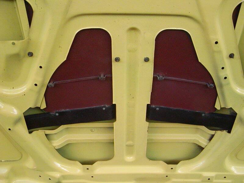

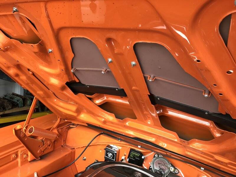

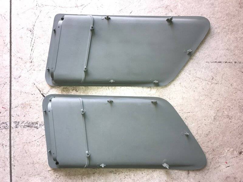

The Phillips head screws are really the only specialty type of screw because of the threads and tip, but realistically you could use a Phillips head machine screw. The speed nuts can be had at any hardware store and the two rivets that hold the rain gutters on are common as well. I don't know of anyone that sells a kit per say. I may have some extra's that I can dig up for reference[but that would take some digging, hopefully someone else will chime in.
