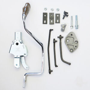

Get a Hurst Compertition Plus mechanism, and the pistol grip handle w/o console. I only have/had OEM, so I can't comment about the quality of the repro handles.
Like mentioned above, Brewers should have you covered.

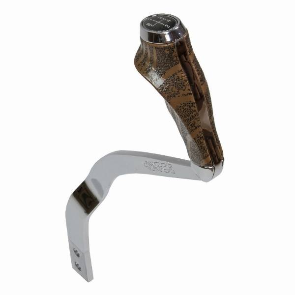

The only difference between console and non console is the actual shift handle. The console handle has a big bow in it so it aligns correctly in the center console if you have a center console.
Non console below without the big bow.
