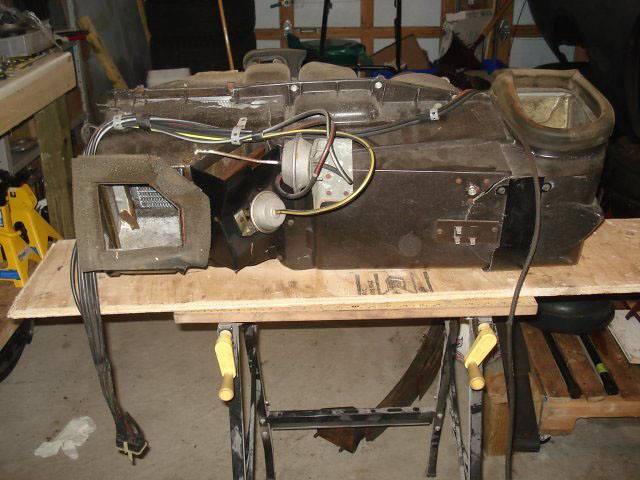

I've got an A/C system that came with my 71 Satellite when I bought it. The car was not an A/C car, and this system was not installed, it came with the extra parts. I would like to know if it's an OEM original A/C that was in these cars in 71. I installed an aftermarket system so I don't need it and will be selling it, I just need to verify that it is for these cars.
The part number on the unit is 3441978 with 85148 below it. I'm thinking it is from a 1978 car with that in the part number but just not sure and not finding any help on searches.
Thanks for any help on this.
Joe
www.mymopar.com
Download the parts and maintenance book. Parts book has numbers towards the back
Just wanted to add that my 72 Charger with A/C is the same as numbers you mentioned above. My build date is July 71.
