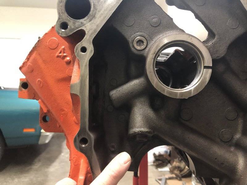

There are two up front under the timing cover. The one that goes in from the bottom (second pic) is the one that typically gets missed.
...and two at the rear of the block inside the bellhousing.
If one of these is missing, you'll know it by the puddle of oil on the floor LoL:eek:
(Photos courtesy of member "4mulas")
Thx alot we are taking apart the front end to check I think you may be right.
