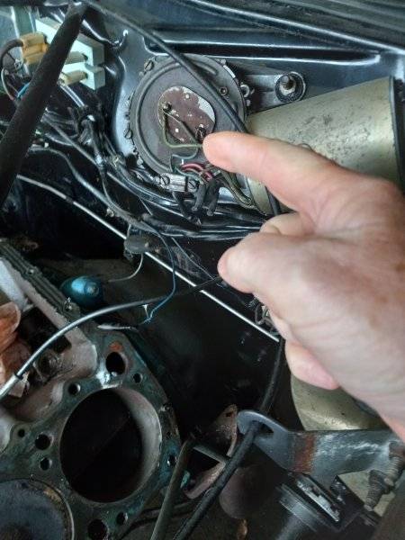

Check out the picture. Is it supposed to look like this? Seems unfinished?

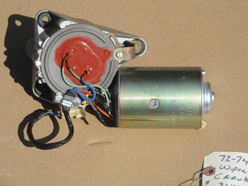

Exactly how it should look.. Here is a pic of one restored from this site..
Looking at it closer it does look like its missing the ground strap...
The barn red paint is to insulate those connections and your is worn off and exposing the connections. It will work fine but don't short it out.
yes the ground is gone and it needs one.
do your wipers work ok?
I have yet to fire up the electronics on the car. Once I have the engine out and to the machine shop I'll start to focus on the electronics as I know there will be issues. I'll check to see if the ground is there.

Confirmed I'm missing the ground last night, Not real sure how to even search on that part.
