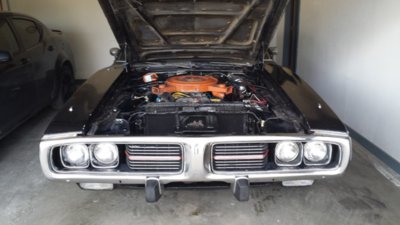

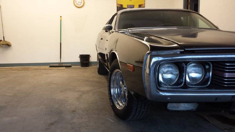

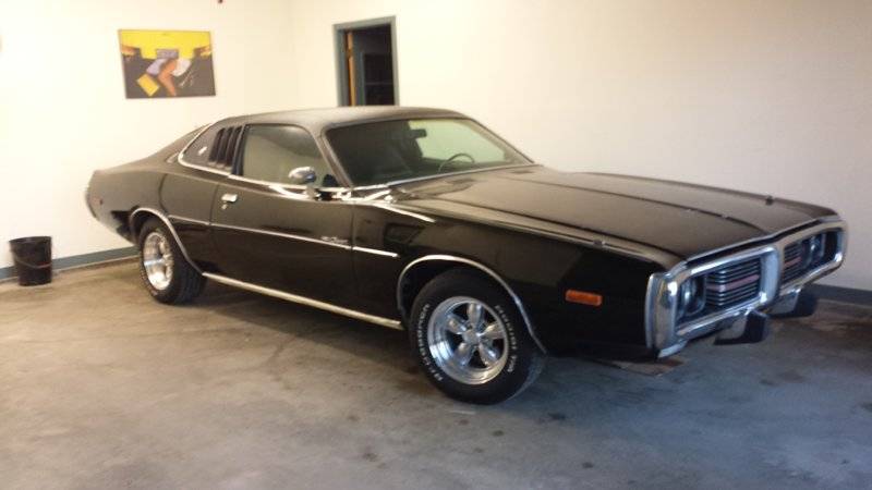

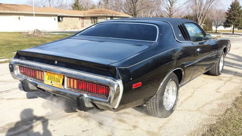

So let's see some pics of your car I'm curious a 73 se 4 speed car?

Yep, the difficult thing about it possibly being a "dealer add-on" is the different firewall (not exactly an add-on part). My bet is that it's either been re-tagged from another car (check VIN on radiator support + trunk lip) OR they just screwed up on the tag at the factory.
That has an A/C firewall. Not easy to change. Could have changed and patched in just that area though.
Non a/c car would have the drivers side vent box thus a big hole in the driver side lower cowl. Could look up under the dash to see if that has been closed up.
If not then I'd say it was a factory a/c car.

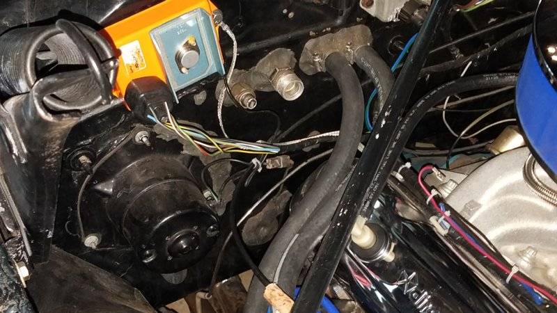

Got a close up of the blower motor area of the firewall?
I agree it appears to be an AC firewall but that tube rising up to the left of the blower motor has me intrigued.
That tube is there on all of them!
What I was getting at is I'm fairly certain all s. e. Chargers had a/c you didn't get the cream of the crop and say no ac please! That car looks like it is loaded except for power windows and a sunroof (possibley Cruse control) it had AC from the factory!
I agree that it's there on non AC cars. AC cars had the tube on the bottom.

@JohnEngland post a close up picture of the firewall in that area.
