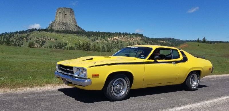

I have a 73 Road Runner with a 340. I stroked it to 416 cubic inches. In my case, I did it to drive across country and I have low compression so it runs on 87 octane fuel. Even so, it is still a monster and accelerates way harder than my 70 383 Road Runner.
As has also been said above, these cars can be made to handle quite well with a Firm Feel steering box (I like Stage II). However, it also requires all the suspension parts be in top condition, and you need the appropriate sway bars too.
You are asking all the right questions - best of luck with your (very good looking) project!
Here is my beater with the 416 small block...
