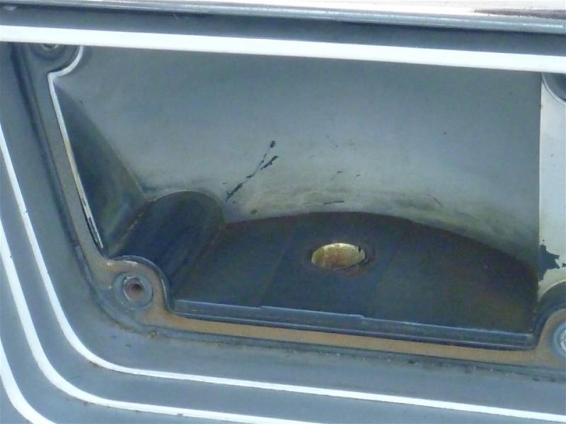

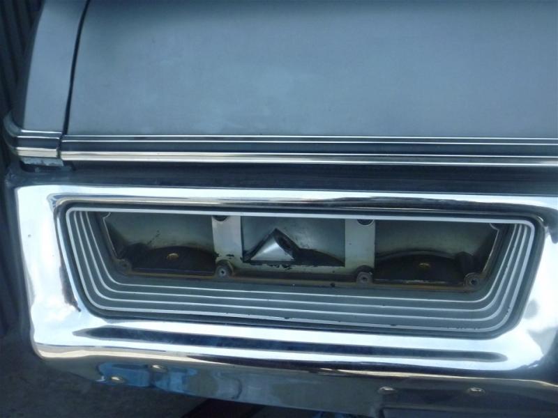

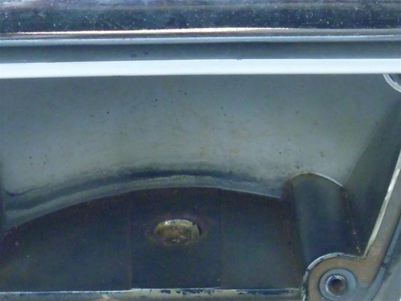

Hi all. I am currently working on a low mile 1974 Dodge Cornet 4-door sedan. It was somebody's mom's car and it has a grocery getter 318 V-8 and Torqueflite powertrain. It also has air conditioning, power brakes, and power steering though.
I'm doing some maintenance of the car and found a couple of dead bulbs in the tail-light assembly. I got the lens off easily enough, but when I went to take out the dead bulbs I noticed that they had significant corrosion on the bases. Of course the globes twisted right off when I tried to remove them. I have squirted some WD-40 down in between the base of the bulb and the bulb socket and tried turning the bulb base with a stubbly screwdriver but so far they haven't moved. Has anyone have a better suggestion as to what I might try to get the bulb bases out?

If you can get needle nose in there, pinch the end of the old bulb together (metal) then turn and pull out.
Yeah, needle nose or snap ring pliers, either one, if you have access, if not, try using a very small potato or cut one that you can push down in the socket and it may just twist right out.
I haven't seen too many 74 Coronets, cool car, had the same problem with my tail light bulbs, same as previously suggested, needle nose pliers, get in there, get a hold of an edge, twist it towards the center of where the bulb was, push down and twist out, usually works every time.
Thanks for the replies. I managed to get the bulb bases out eventually but the sockets are pretty rusty and I'm thinking it would be wise to start looking for a replacement tail lamp housing. Has anyone got an idea where I might source one (both left and right side)? It doesn't help that it is an unpopular car not seen much now but surely there must be some decent ones with good unrusted bulb sockets left in some Southwestern boneyard?
