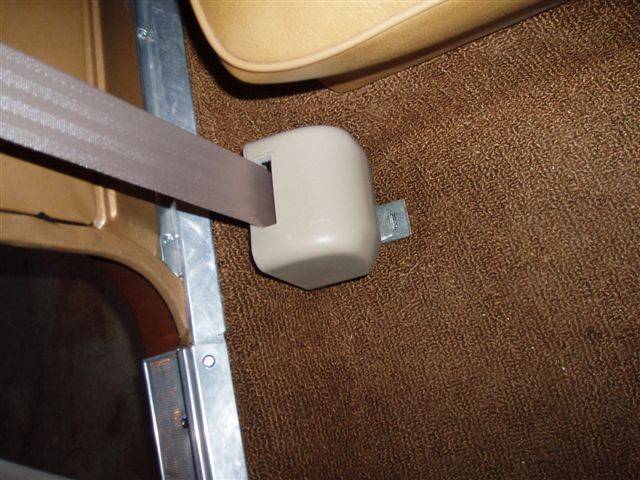

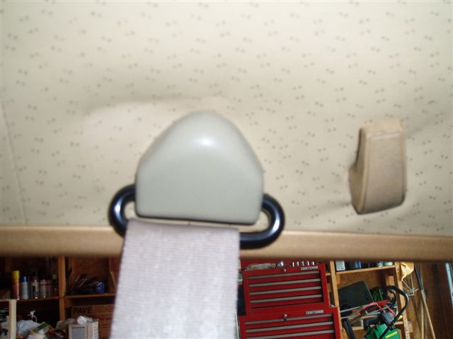

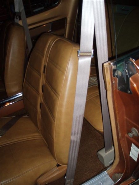

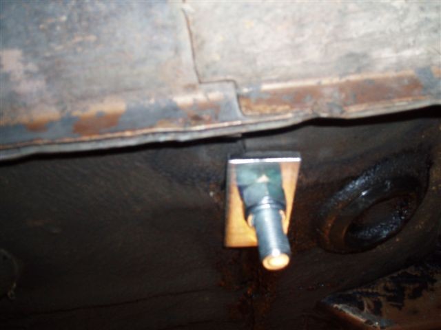

I see where the retractor is mounted & is there a bracket that comes with the kit? I've seen some belt kits that have a "drop down" piece that attaches to the mount on the roof rail. Does yours have that because it almost looks like the chest belt would come across your neck.
I made a bracket to mount the retractor to the rear floor. I saw the drop down piece you mentioned, but honestly the belt fit fine in my car without it. I think it might be needed in trucks or sedans with a higher roof.

I never had an issue. This is the only picture I could find of me belted in the car. I guess you could always order the extension, and then decide whether you need it or not.
They call that a 'shoulder loop'. I bought the extended one because that's what my car came with and I thought it would save my shoulder. The junky universal retractor doesn't like the shoulder loop and acts like a brake. So frustrating. I'm thinking of sending in my original seatbelts to get re-webbed with another company.

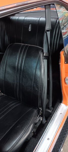

I bought 3 point belts from XV Motorsports. They have that drop down "sash" that does help align the belt to rest across the chest and not the neck.
You're tall so it isn't as much of an issue but the shorter people will still have some trouble with the belt near the neck.
The factory seat belts in the mid 70s Mopars had that drop down sash too. They really do help.
