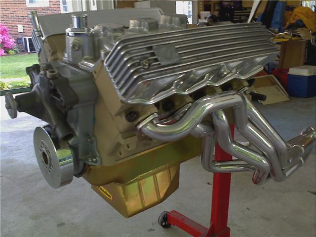

Take it from someone that has a lot of time and money invested in a Poly 318, get in touch with Gary Pavlovich in California, 619-572-3008, he can tell you how to order the new 4bbl intakes for that engine and for headers, TTI is the only way to go for a Poly.
Poly 2.jpgPoly
Mho tti is it. On a side note, I met Barns Daniels from the Ramchargers a few weeks ago. he was the A block guy and he is still into these motors. Good luck with the project.

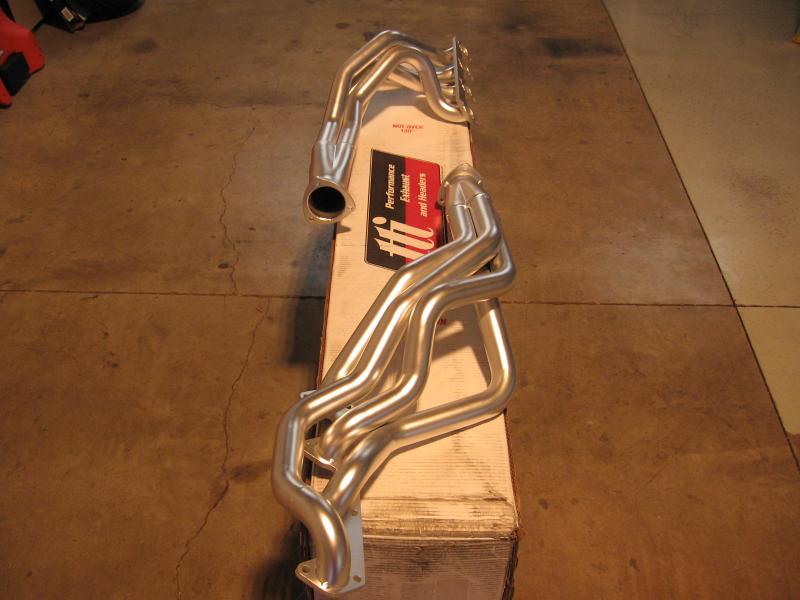

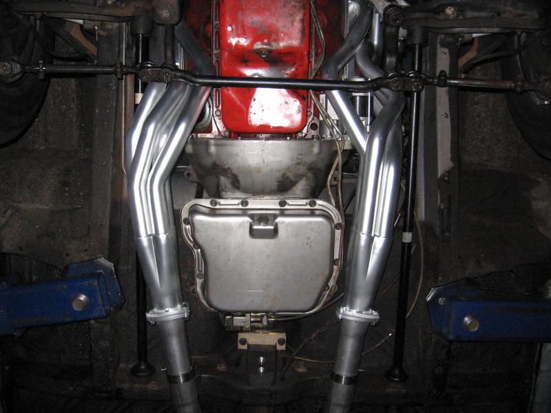

TTI's on my 64 Belvedere "Poly" All stock internals but I installed a Weiand intake and a 600 Edelbrock.Electronic ignition too. What a huge difference in performance.
