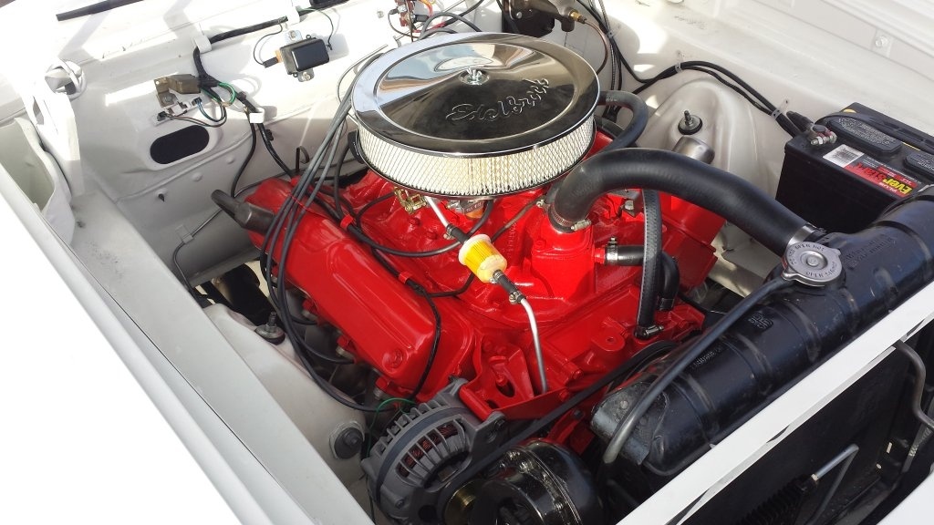

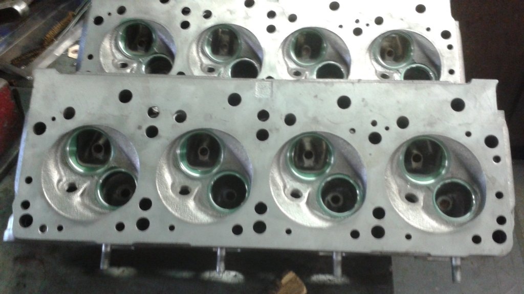

I had mine done by Gary Pavlovich and am happy with the results. Nothing extraordinary but it is a strong motor. Cam will make a huge difference but to get the power a set of headers is a must. Plus a 3 angle valve job and some port work to get them to flow.
threewood, what do you reckon your HP is or around? Just out of curiosity if you've done this check post rebuild or know this, what's the compression? I have one weak cylinder #2 pumping about 100 and others are around 120-125. my motor still runs strong, uses no oil...go figure. Fact the motor has run so well I've kept putting off the rebuild but getting antsy to have more get up and go (to include the 727 rebuild as well). thanks.
Horsepower estimate is a slippery slope. I would think with my mods it would be in the 340 range but that is just a guess as i have no 1/4 mile times or dyno runs. My compression is 9.5 to 1. You can get above that but it involves custom pistons which adds quite a bit of cost. My block was decked and heads milled to ensure straightness which helped the compression numbers a bit. I didn't go stroker for the sole reason I wanted to keep it reliable.
I was the same way, I wanted to keep mine as stock as possible. But then I wanted more power so the 2bbl had to go, then I needed headers to get full benefit, larger cam, head work, etc. I rebuilt the pushbutton 727, added a higher stall TC and governor that shifts at 5800.
