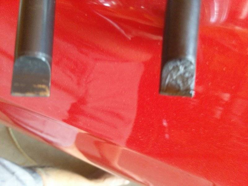

Only reason I’m asking is gauging the wear pattern, my MSD pro-billet only engaged around 1/8” into the drive gear with the correct 3.5” mounting surface to tip. New MSD Distributor is 3.375” (slightly out of spec) so it’s an 1/8” shallower. I’m not sure if this actually makes a difference and what the actual load is on the distributor tip. If they weren’t side by side most wouldn’t notice. I’m just surprised these don’t actually seat deeper. Oil pump drive is from Mopar Performance.

It doesn’t seem that many people actually measure the depth the shaft tip rests into the slot. Just thought it was a bit interesting that the correct (to spec) Distributor has a wear pattern only slightly over 1/8” on the tip. Check out the grease on the new one, and this is from MSD, everyone would expect it to be correct and it sits into the slot correctly (1/16”) so no one would even know unless they measured, and why would someone if it dropped right in with no issues?

Oh sorry, yes, this image was just comparing the two. From the mounting surface, the new Hyperspark was an 1/8" shorter than the Pro-Billet. Both are built by MSD, the Hyperspark is branded by Holley. The MSD Pro-Billet was exactly 3.5" from the mounting surface to tip of distributor shaft. The Hyperspark was 3.375" from mounting surface to tip of distributor shaft.
