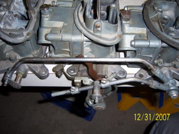

Mopar did sell them through Direct Connection and all three carbs had accelerator pumps and the center had the choke, popular upgrade for racers in the 70's, and they are completely different carbs than the vacuum ones.
There is linkage that "converts" the vacuum carbs to mechanical also, but I think that was aftermarket type stuff, not sure what you have to do to the vacuum pods so that they don't interfere. Also if a setup like this is used, my understanding is that opening the outboards manually without accelerator pumps on them it will just bog and never work correctly.
Either leave them vacuum or get the ones with accelerator pumps on all the carbs.
here is a pic of the aftermarket linkage
there never was a mechanical 6-pak carb system from the factory. there was an aftermarket set-up that could be bought at speed shops in the early '70's. i had one of those mechanical set-ups on a 383 back in the day. drove good, easy tune, but really killed the torque off. vacuums are the best for street use. corvette 3x2 carbs work very good on a 383 but may require fuel line and linkage hook up mods. if i had to have a mechanical set-up i'd probably try a pair of 500's for outboards and a 350 center carb.

i don't know anything about TMP carbs. i would caution you to be careful about buying something "modded up to fit". cfm numbers for 2bbl carbs are mostly marketing hype and aren't real. i still look at venturi area/throttle bore sizes rather than relying on cfm numbers. the best suggestion i could give you is to use the factory vacuum carbs. the factory vacuum carbs will work on the 383 and work very well on a 440, plus all the brackets are easy to get. i've used the mopar vacuum carbs on 383's and 440's and feel they are superior to the aftermarket 6pak mechanicals in a street/strip car. i believe the vacuum carbs will average more torque over the entire power curve. the corvette carbs are vacuum and work very well on a 383 but have the fuel lines on the throttle side and automatic kick down linkage is an issue.
