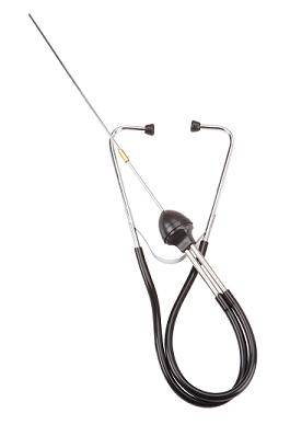

Couldn't really tell from your video. These might look stupid but they can be handy. Especially for listening to tappets.
$4 at Harbor Freight.
