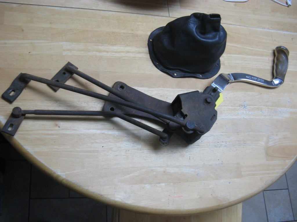

Hey guys I was wondering if the shifter location is different in a bench seat car compared to a bucket seat car. My car is an auto console car but I want to put in a buckets buddy seat combo with a 4 speed. I know the shifter handles are different. Thanks.

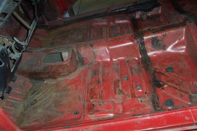

The hump is different
It is with the 2 Plymouth 4 spd cars I own
The bench shifter has a dog bone bracket
To move it's location and also different shift rods

AMD even offers both humps.
Console (and buckets, no console) cars used the E body shorty shifter and the rear shifter mount on the trans.
Bench (and buckets with buddy seat) cars use the forward shifter mount position with the dog bone and a shifter that looks like a 70 bench seat shifter but not quite as long.
Brewer's site has pics of everything.
You could theoretically move the buddy seat back just a bit and use the rear mount, hump and shorty shifter.
You could NOT do that on a bench car.
Bucket seat 71 style...

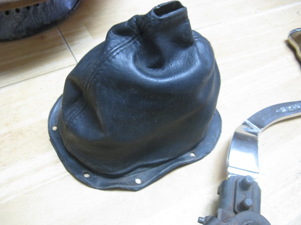

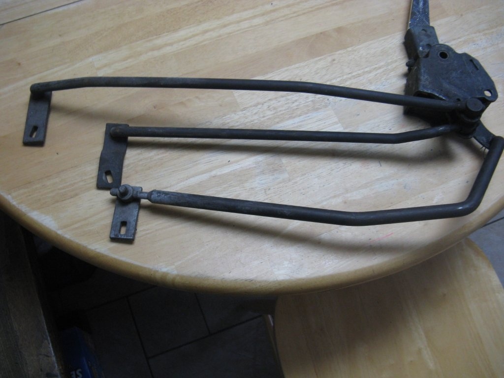

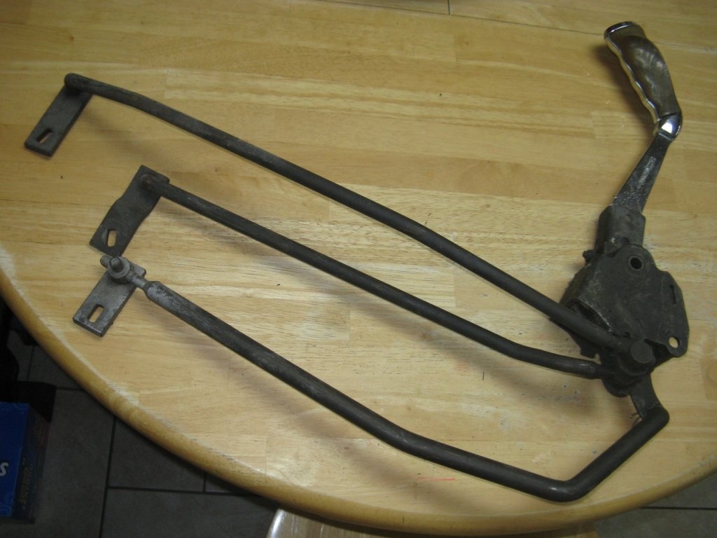

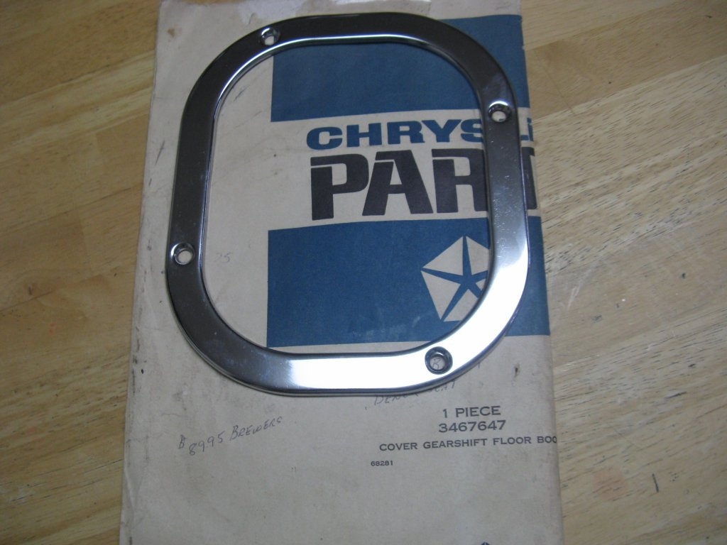

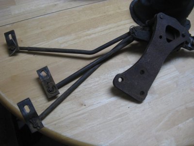

Corrected 72 bench seat with dog leg. Even takes a different shifter boot and ring....
^^^ that bench seat one is what I want to put in.

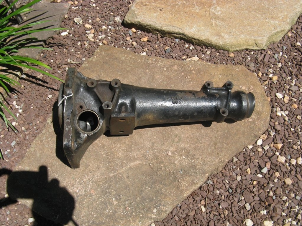

Does the dog bone mount to the front pad of the transmission?
Yes. Your transmission has to have this tail shaft with both mounting positions...
