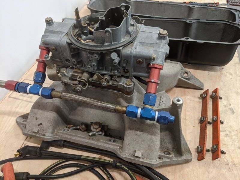

Holley 800 cfm carb

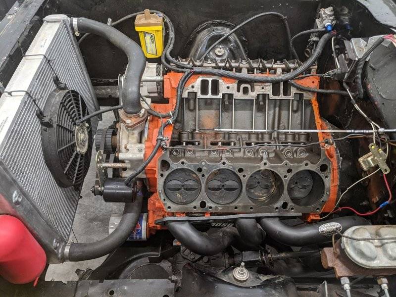

Pulled a 727 out of a junkyard also, can’t remember what it came out of but was built with a manual valve body. 3500 stall converter. 8 ¾ rear with 4.30 gears and 28x10 slicks.
I raced 3 years when I was in the Air Force but after I got out I moved around for work and didn’t have a garage so it sat in the car trailer for the past 12 years. Last time it ran was 2007. Now that my budget is no longer shoestring and I have a nice heated garage to spend my winter in I want to get it track ready.
Lots of work to do and now that I am a little older and wiser (subjective, I know but give it to me!), I want to do it cleaner and better. But I’ve also been out of the game for so long I am looking for some advice.
I would rather not touch the short block if at all possible. I know that I need a new cam/lifter/push rods/ and valve springs at a minimum. I am considering aluminum heads since I already have to buy all of that. I also need a new carb but from what I understand the M-1 single plane is still a decent intake.
Car ran 11.80’s back in the day but I always struggled with a major stumble off the line. Messed around with the cams on the carb but never had much luck getting it to launch consistently. Always had the best luck if I got to the line right around 180 degrees but if it was colder than that I would bring it up to about 2800 rpm on foot break then launch it and it falls on its face and have to peddle the throttle to keep it running then she would take off.
So what I’m looking for is advice on cam/lifters/valve springs. If I’m doing all that should I go aluminum heads? Can I get a higher compression ratio without touching the short block? Solid lifters perhaps? Carb choice? If you were building this for pure track use, what would you put into it?

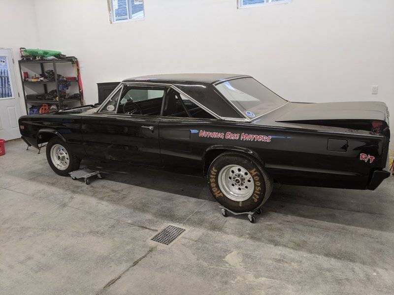

All my racing days are old school, so I won't be much help with today's cams, heads, and lifters. I did want to ask what was done to the rear quarters? Looks like they could be 66-67 Charger.

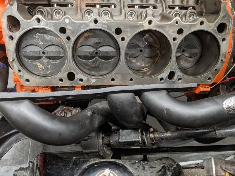

Are those 6 pack pistons? if so, I'm sure you know the notches in them were meant for 2.08/1.74 valves and will cause a clearance issue with your larger valves if you go too big on the cam. I had an old bracket engine I bought that had 6 Pack pistons with the larger valves in the heads, and every piston had a valve hit on the edges of the factory valve cut. It never bent a valve, but it was there :)

I personally wouldn't run less than an 850 double pumper for a carb, especially on a track toy. In my admittedly limited experience, 440's love fuel.
I believe they were rolled like that by a prior owner. I think all the metal is original.

The budget is "bang for the buck". Could I spend a grand and get it running....sure. Could I spend 4k on a new top end...ya but I'm not sure I'm that invested yet. That's why I am hoping to see what people have to say and then I can kind of weigh....and price my options.
The motor was built by an experienced shop that did a lot of mopars. They coordinated the head work with the guy that ported and flowed them. So I would like to think all the parts work together. That being said, 19 years later and I can't remember what is what in the bottom end.
11.80 wasn't to bad for a .484 cam. You can definitely gain from a cam swap. I would go with a solid. You could probably be creative and tweek the valve releifs on the 6 pack pistons to get the proper clearance if you find out it doesn't clear. Regardless of the cam upgrade you need to use clay to check your valve clearance. We've done a .557 mopar solid with the same combo you have and it cleared...however we were running 2.08 intakes and 1.88 exhaust. Their are much better cam designs now...we've been happy working with bullet cams and they have custom ground the last 5 cams for us for really no more then ordering from summit with quick turnarounds. It's my understanding someone from crower is on this FBBO .. We've bought a cam from them recently too.. I would not do mopar performance anymore. Jones and hughes also would be 2 cam companies 2 consider. You could keep with the hydraulic cam but for what your doing I would go solid.
I think their is plenty left in your combo just with a cam and valve spring swap. You could get another point of compression out of your heads by having them milled but you will loose valve clearance. A 440 is easier to use a milled head vs a low deck 400. Also use the thinnest head gasket you can. Hard to advise you on a cam without knowing if you are staying with a hydraulic or a solid. Also a cam with lots of lift you may find how big is to big with the clearances.

Let's assume that I am going solid. Also, how can I tell if they are 6 pack pistons? Can I measure the valve recesses or is there a better way?
Edit: pistons have L2355 060 on them if that helps identify what they are.
L2355 is a forged replacement of the 440 6 pack piston. They are a common piston that is very heavy an been around a long, long time.

Yes...with the 2355 pistons I would prefer to run the valve size the eyebrows were designed for which is 2.08 and 1.74 (stock). You can run a larger 2.14 or 2.19 intake and a 1.81 or 1.88 exhaust but those pistons would need to be flycut to get the proper valve clearances. Your chances of things clearing are much better if you stay with the valves you have.

A aftermarket head would have a lot more hp potential but the bigger valves are going to be a poor match for the pistons unless the v. releifs are cut bigger. The problem is the bigger releifs will lower the compression further. The optimal build with new closed chamber heads would include a piston upgrade with 2 valves releifs vs 4.... the piston would be lighter, higher compression and possibly 0 deck w quench . But then it needs to be balanced again and a good set of aftermarket connecting rods are in order to handle the hp of your big hp heads. At a certain point it makes more sense to build a new motor. It's really pretty respectable the way it's set up now. Maybe a 150hp shot for a little more kick along with a cam that's meant for the strip...maybe more stall converter too.

After some thought and the advice in the thread I'm leaning towards a new solid cam set up. Putting aluminum heads on with the current pistons seems like a waste for now. I have a lot of money to spend on other parts of the car as it needs disk breaks, suspension, fuel system, carb, slicks, and just a lot of general clean up.
I'm going to give Hughes a call and see what they suggest for the cam and rest of the valve train. That will get me back on the track next spring and maybe in a year or two I'll build a new motor as a complete project.
I'm pretty sure the 2355 valve pockets will clear 2.14 valves for most applications.

The valve pockets will be 6 or 7 cc

I think 2355s have a 2.2ish fly cut??.. meaning a 2.14 fits tight....but I could be wrong. It's been 15 years since I have built a engine with those pistons..so my memory is a little fuzzy. LOL
