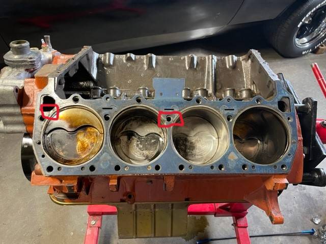

Appreciate all the comments. Heads are off and burnt between 3/5. I think I said 1/3 before. Also forgot I used ARP lube on the original head bolts from TF which makes me wonder if ARP actually made the head bolts? I guess the 8519 were in there before. I thought 1009 were used. I was thinking the 4.380 from Cometic would be better on the over .030 of 4.350? Just looking for knowledge from the group as this is not my area.

Those gaskets are the cheap stock replacements. It looks like the heads were over torqued. The gaskets are stretched and distorted. The 1009 race gaskets would be a definite upgrade, and the cometics would be the best answer.
What you have there is a very uncommon failure, that I can only attribute to an overtorque condition.

wow! that's the first time i've ever seen a fel-pro blow like that. usually the 1009 blows between the two inner cylinders; i know i had to weld some heads up. my guess is when the engine got hot it must've "really" got hot. alum expands different than iron so i bet the head lifted. also i always relieve the dowel pin holes in the head to make sure the head doesn't fit tight. i believe alum heads need a little wiggle room to grow when hot. alum isn't as stable as cast iron and i always chase the head bolt holes to try and find an extra thread or two as previously mentioned. you can look at the bottom of the bolts to see if they have bottomed out. a 1039 gasket is a little thicker. also those look like Icon pistons which i'm using in one of my engines with 8519's. i've had no issues, but i don't have any detonation or cooling problems.
