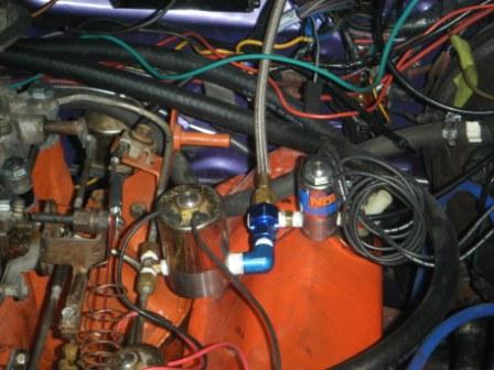

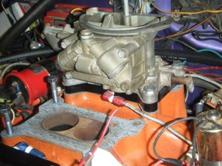

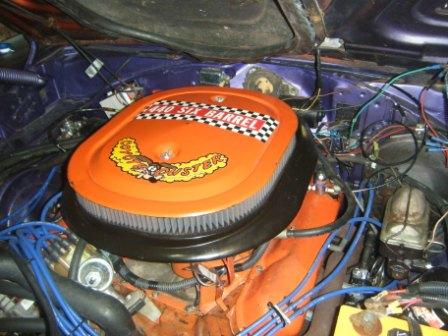

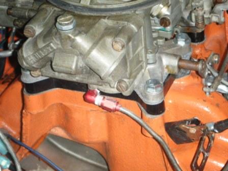

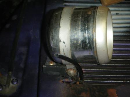

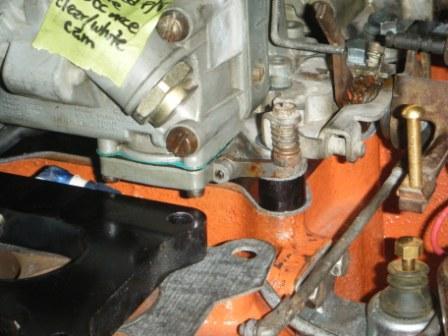

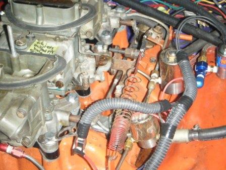

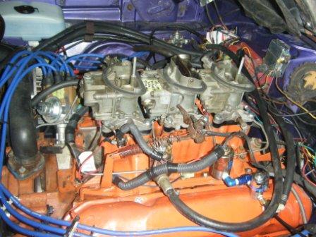

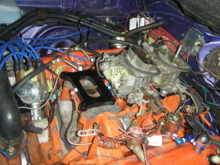

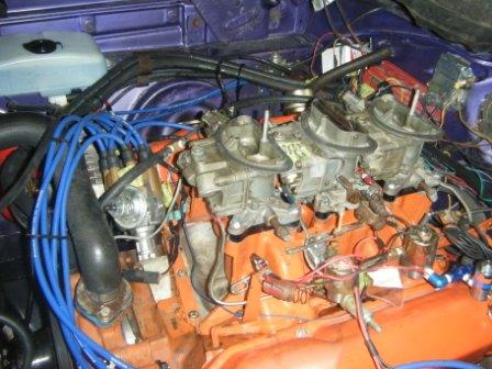

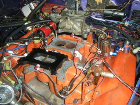

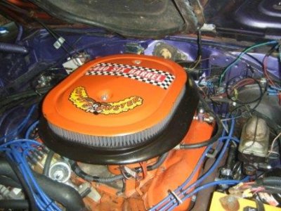

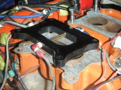

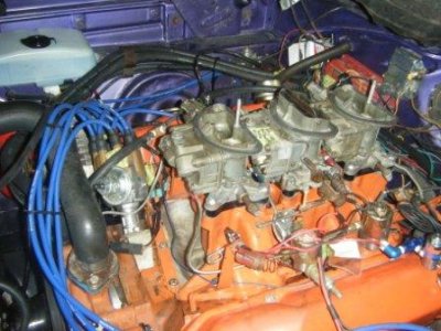

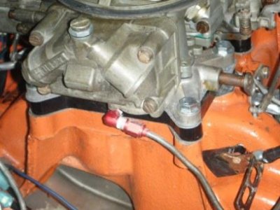

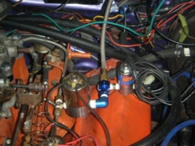

Hey Everyone, Since I put the six pack back on my Road Runner I went ahead and put the nitrous system b1ack on. It's THE LAST six pack Cheater system built by Nitrous Oxide Systems. Enjoy! 1 Rear Carb Plate COMP.jpg2 Rear Carb wPlate COMP.jpg3 Center Rear COMP.jpg4 Center Carb Spacer COMP.jpg5 Front Plate Closeup COMP.jpg6 Front Carb Plate COMP.jpg7 All 3 Carbs COMP.jpg8 Throttle Switch COMP.jpg9 Complete Closeup COMP.jpg10 Purge Solenoid COMP.jpg11 Purge Tube COMP.jpg12 Bottle COMP.jpg13 Complete COMP.jpg14 Complete w Air Cleaner COMP.jpgPistol Grip COMP.jpg

He has a wet kit above... the red and blue fittings are how you can tell. Fuel and nitrous. Fuel is red Nitrous blue, standard color codeing system to not mix up the lines.
I'm also guessing he has an elec fuel pump ? When the shot hits it will push gas and n2o.. But you need to maintain fuel pressure so you dont lean out and burn a hole in your piston.

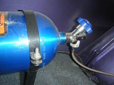

His tank above needs blow off tube as well. Nitrous is cold and under pressure and the hotter it gets it expands.... it will blow the safety cap and evacuate the bottle in your car...LOL SO you run a tube from the blow off cap to the outside of the vehicle just incase it happens... youtube that one too.. people in the south do it all the time.. forget they have their bottle in the car and on a hot summer ... BAWOOOOOOOSH !

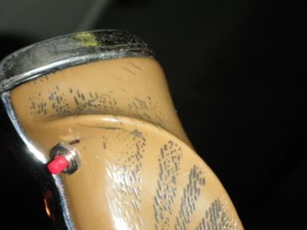

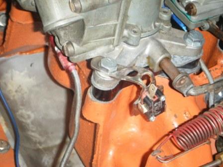

Yes, this is a wet system and I do not know of a dry system for carbureted engines. Pictures 6&7 show the full throttle activation switch (activates only if front carb is fully opened). For the nitrous to turn on it needs the activation switch on, the red button in the shifter pressed and the the full throttle switch (carbs all the way open) switch pushed by the front carburetor. I don't have a window switch, so I rely on my tachometer & don't press the shifter button until the rpm's are over 3000rpm. I've gone up 3 sizes in the center carb main metering jets. The system is set up for 2 Holley blue electric fuel pumps, but only 1 is installed right now. I think I'll need the second pump to run the 250 hp nitrous so the nitous has its own fuel pump. Yes, I need a blow down tube for the tank a bottle heater and a nitrous pressure gage too. Nitrous can do very bad things sometimes and I've blown two engines using it. One ran a little lean, melted the tips off two spark plugs and broke an exhaust valve when the fuel pump couldn't keep up and another was a big nitrous explosion when the fuel puddled in the intake manifold when I hit the nitrous off the line instead of over 3000 rpm.
Running lean (low fuel pressure or too small carburetor jets), running too low octane fuel (93 minimum & NOS recommends 100-110 octane for bigger nitrous shots), timing too far advanced (need to retard it for nitrous - I have a timing delay box installed but not hooked up yet), narrower spark plug gaps, colder heat range spark plugs, and a very good ignition system (MSD 6A w/MSD Blaster coil on mine) are all things to consider. You also need forged pistons and strong rods/crank/rod bolts.
I have never had a bottle in the trunk or other hidden areas in a car/truck in summer ever blow off, since i started doing this in 85.
That only happens with heating bottles and leaving the heaters on that aren't on temp switches.

it is an oxidizer & a cooling agent {-409*f}, along with pressurizing the cylinder {blower in a bottle}, never fill a bottle or let it get above 1200psi helps too, the bottle position is important too the inlet tube should always bee submerged, which usually means the outlet/fitting needs to be pointed down, a blow off valve needs to be vented outside the car... I usually had my bottles mounted at a 30* angle too parallel with the frame/front to rear....
