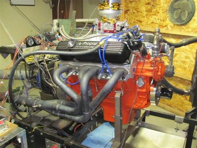

448/440 we just finished, for I believe a '72 Satellite. 572 lb-ft @ 3,800 rpm and 593 hp @ 5,900 rpm
.040 over factory '72 block
10.6:1 running on 91 octane
950 Quick Fuel
Edelbrock RPM Performer dual plane
Victor cylinder heads prepared to flow just like the Trick Flow 240 CNC heads
Custom Comp Cams solid flat tappet
Hughes Engines 1.6 rocker arms
Scat H-beam rods
SRP flat top pistons
Stock forged crankshaft
492 lb-ft @ 3,000 rpm start of dyno pull and 496 lb-ft @ 6,100 rpm end of dyno pull.

Thanks, It's not too bad with 557 lb-ft @ 3,300 rpm and 550 lb-ft @ 5,100 rpm

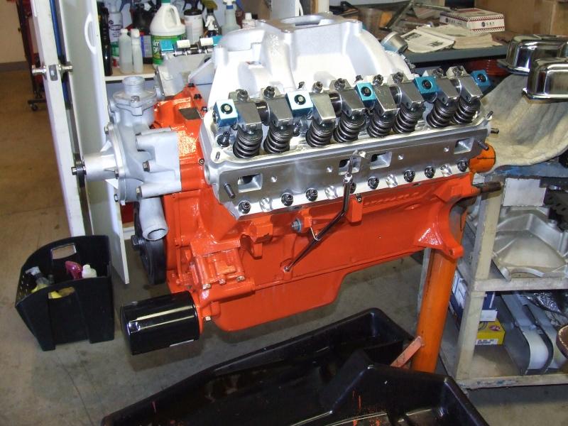

It was a joke - When Jim built my engine last year I sent him an email that said: "Jim, is it sacrilegious to paint a 440 Hemi Orange?"... and He said, "If you want your engine Hemi Orange, your going to get it Hemi Orange!"
And, I got my engine Hemi Orange, LOL! The Hemi Orange looks great don't it?...
