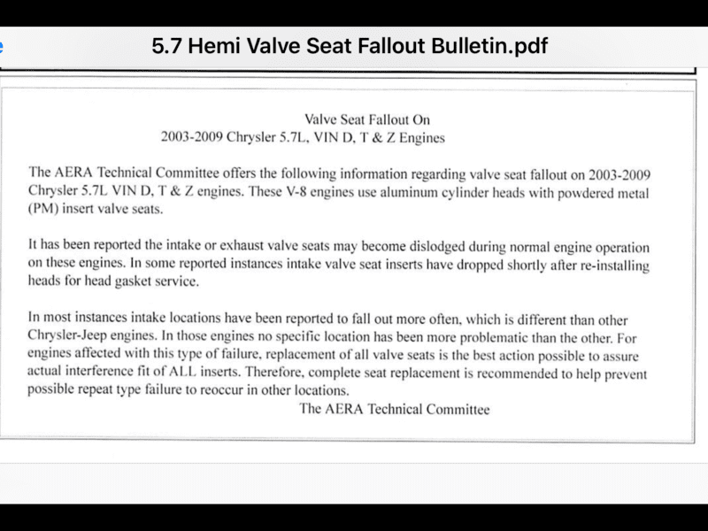

Dodge 4.7's mostly, but the bulletin could include 5.7's, I would have to check at work. It is known that the bore for the valve seats were cut without sufficient interference fit. Overheating the engine is the most common issue here. I have had a few heads come thru with dropped seats, and cut for a new oversized seat to fix it. The bulletin recommends replacing all of the seats, but have not had anyone want to spend that much yet. I charge $12 per seat, plus the seat at about $3 - $5 each. While I don't find $192 for the labor, and $80 for the seats too much, I guess a total head work price of $670 for cleaning, straightening, seats, valve job, milling, shop supplies, EPA, and tax kind of makes most people shy away from doing it properly.
The problem is definitely with the 5.7 Hemi. Nothing to do with overheating or anything else you can try to blame it on. Pure and simple, the valve seats don't have sufficient interference fit to hold them in tight. The seat problem always happens when just starting the car after being driven long enough to warm up. They don't admit any fault but they made changes to the heads in 08. I am part of a class action suit for this. Mine happened after coming out of the Dr. office from an appointment. Turned key, car started, immediately sounded like loose nuts and bolts in an old metal coffee can. No overheating, no high rpms, no warning. 2006 Dodge Magnum R/T 5.7. Last October with 80,000 miles. Nothing but 5w20 Mobil one. Took to dealer and they said it was not a common problem. I asked how much for new heads, they gave me a price but said they were on Back order. Hmm......I actually expected it and was shopping for replacement heads when it happened. I had just hoped for it to go at least 100K. I have looked on many sites on line that are similar to FBBO in that they are owners of 5.7 powered cars. Common on all sites. I waited for my tax return and got a new/remanufactured replacement engine. Came with New, upgraded cylinder heads, upgraded timing set and oil pump as these have also been a problem of the 2003-2008 5.7. Cost $2600 for the engine including shipping the old engine back for a core credit.

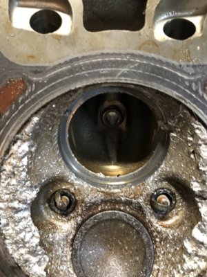

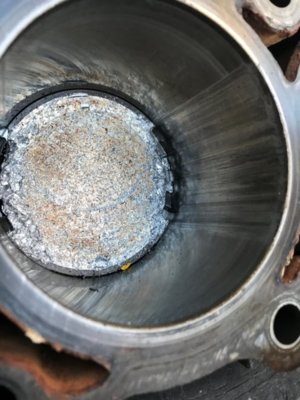

The early gen 3 Hemi uses powdered steel valve seats thats why they drop mostly the intake
