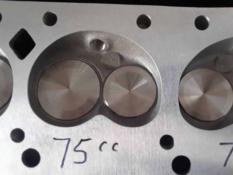

Flat top ICON pistons, zero deck, .035 quench, Stage VI heads, some porting.

View attachment 736940 Flat top ICON pistons, zero deck, .035 quench, Stage VI heads, some porting.
I would be surprised if the Engine wants/needs any more than 34*/35* total timing, even at your elevation with the Flat Top given correct/safe Jetting.
One thing I am absolutely positive around, is 38* is ASKING for TROUBLE !
If you are all concerned about detonation as your Ring Pack inquiries would suggest ? why in the world would you even think about 38* using a Flat Top Piston choice?
I guess I'm just curious after Dyno'ing HUNDREDS of BB Mopar race engine combinations 500-1,000 hp, just where 38* would come from for a Bracket Engine combination ?
We also see PLENTY of Flat Top combinations as high as 850hp that want NO MORE than 32*.... with power DROPPING past 33 *
WHERE does 38* come from ?
Mopar started recommending it in the late sixties on hopped up factory engines and the Mopar crowd took it as gospel. 38 was never intended to be carried over into every last build, but it’s still stuck in the oldschool crowds head. Kim
Well I may be able to get that 38* timing figure out of my mind. But it will take some effort! LOL. I'll start back down around 32-35 total, and go from there.
