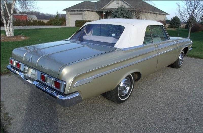

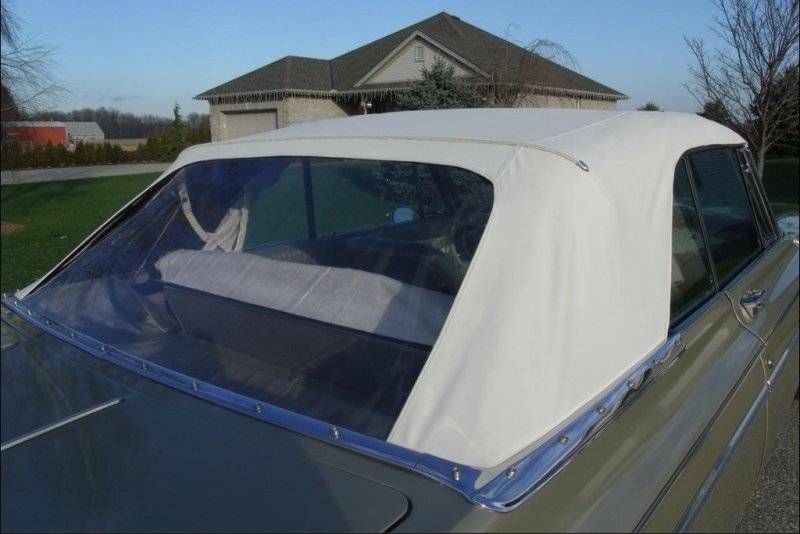

I bought a new top from Legendary Interiors years ago when restoring my 1964 Polara 500. It looked very good after installation, and installer had no complaints with fit. Classic Industries also lists tops in their catalogue. 1964 Fury, 1964 Polara, 1965 Satellite, 1965 Coronet convertible tops are all the same. The hard part of top replacement is having a good front weatherstrip retainer. This is a sheet metal piece that is quite often rotted out because water sits under the front top bow. It has never been reproduced because of its convoluted shape.

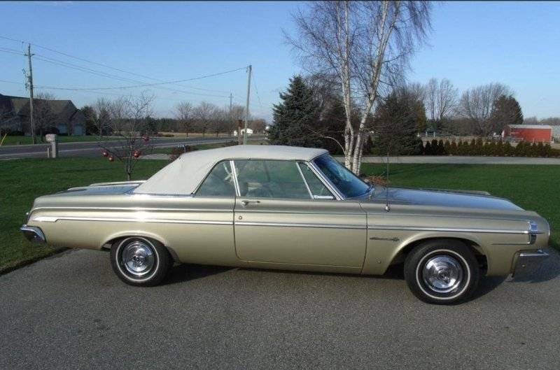

Your car looks just like the one that I had in the late ‘70’s. Mine was originally from California and had power windows and a factory AM/FM. I bought it with a blown motor and replaced it with a 383 2 barrel. I had about $1,000 invested in it between the car, motor, new top and exhaust.
