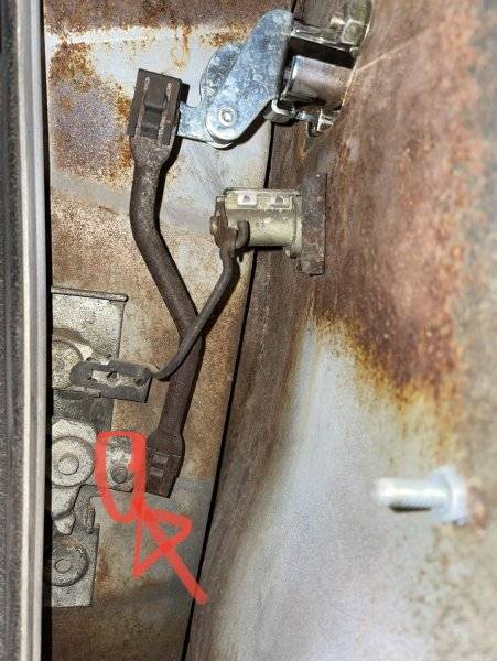

random question here, my 1966 coronet doors wont lock - is it possible the wrong locks are installed on the door? or wrong arm?
in the picture, the rod that goes from the lock to the locking mechanism within the door wont extend high enough to let the lock gear engage
from inside the door, the lock looks to be new, but the rod and all other gears look to be old.
when i look up a replacement set online, every kit comes with a different shaped rod than what i have
is it possible i have the wrong rod, lock, or door hinge pin?
any help is appreciated!
Right in the middle of the lower circle, is that a screw? Is there a corresponding hole on the other side? Might be an adjustment there

This little guy? I think it is a screw but I didn’t see a possibility of adjusting last time I was in there. I’ll get in there in a bit and try messing around with it

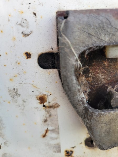

Yep there's a little Allen head screw for that adjustment from the out side. Loosen it up, you'll see

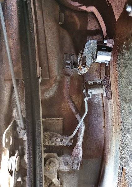

Here's a pic from my 67 coronet parts car for comparison purposes. Drivers door 4dr car.

negative, they wouldnt do it with the door closed either. just fixed this with the adjustment screw noted above.
