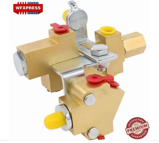

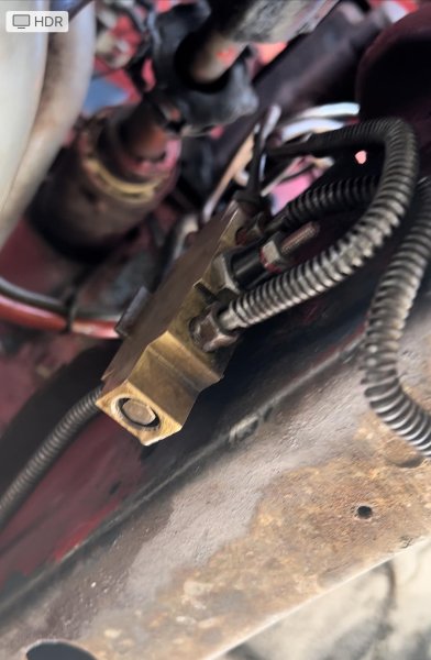

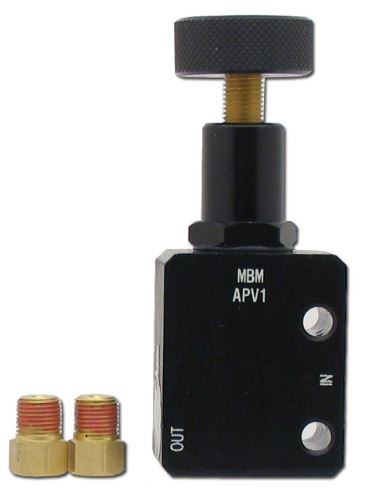

My metering valve and adj prop valve
Adj prop came with kit
All in one that I would have to buy

My metering valve and adj prop valve View attachment 1491878Adj prop came with kitView attachment 1491875All in one that I would have to buy View attachment 1491877

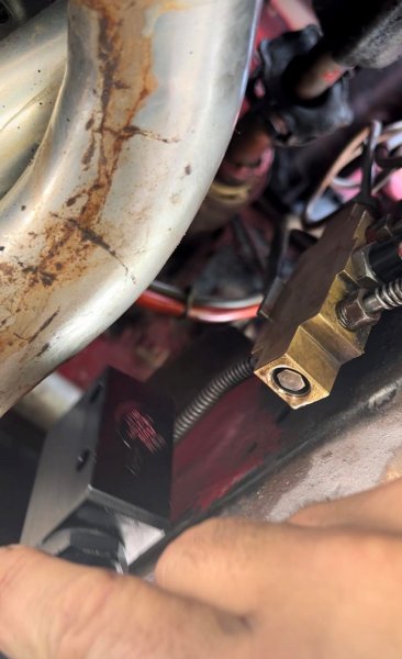

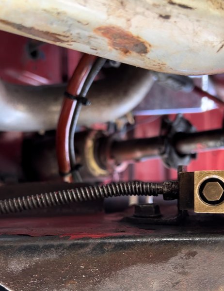

Update - this is what I did. Wound up putting the adjustable proportioning valve behind the metering valve to the back circuit.
I built my own bracket, and the knob is facing up. It is nicely accessible from the alignment panel behind the front tire. Hopefully
it won't leak. I am now struggling with the master cylinder/power booster plate. Posting the question in a new thread.
