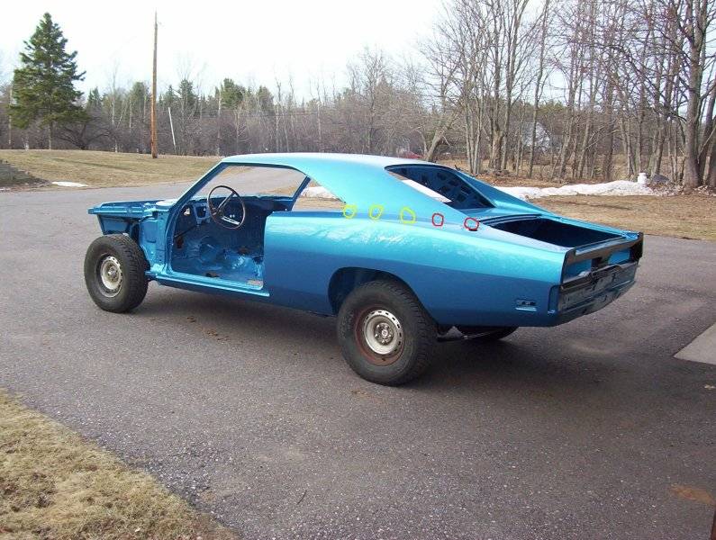

They should line up with the holes at the base of the sail panel (if it’s a vinyl top car).
You have spring clips where the stud and nut clips go. They are accessed inside the trunk. The other two or three spring clips go in the front holes.
Three yellow are spring clips the two red are the stud clips.

The picture on the right is correct. Just bend the wire down so the wire goes into the molding groove. No idea why they have extra spring clips. My photo is from a vinyl top car.
