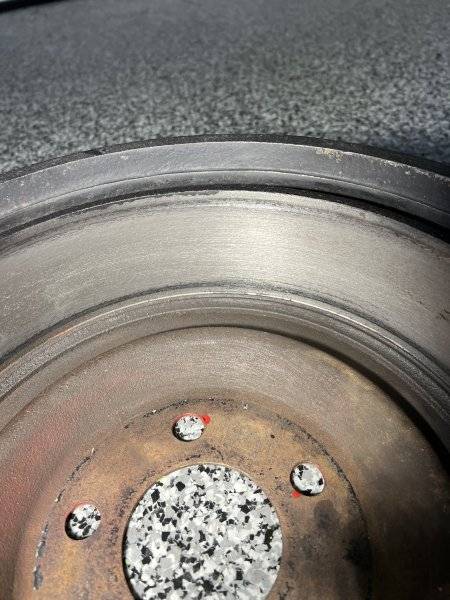

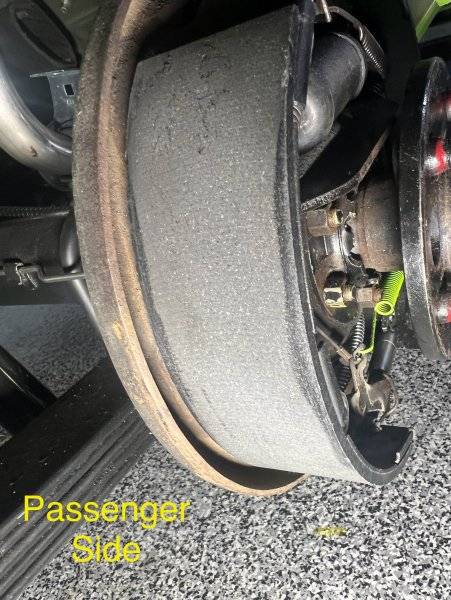

update 10-17- 2023 I added some photos. I'm trying to do this methodically. photos are my right and rear wheel set up. Everything is new. If there's something that looks wrong please let me know.
It looks OK. I will move it to the proportion valve, and the master cylinder/ brake booster. I'll provide information on that today or tomorrow.
A pic and description of your booster and Mc setup will help everyone a bunch.

Are the rear drums adjusted properly?
Not likely but maybe you have a small wheel cylinder leak and the shoes are grabbing in a rear wheel causing the drag from a stop. Pull the rear drums to check for this.
