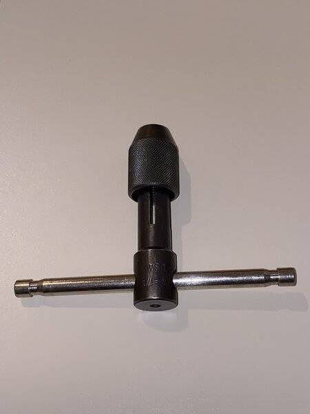

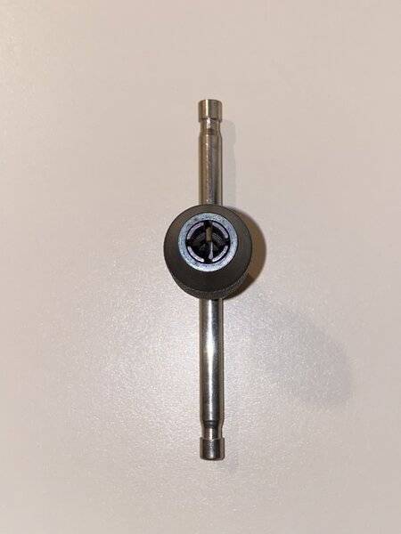

The guy in this video uses a Tap driver with a female 3/8” socket hole on the rear end of it. I can only find Tap drivers with T-handles, which cannot be used with a torque wrench.

How do you guys adjust the bolt without using the “special” tools listed in the manual? Or is the Tap drive that with a socket, like in the video the only way?

Snug the band gently and back it off. No need for a torque wrench
A 5/16” open end is the closest fit on the bolt, but a little loose. I also have a small adjustable wrench I could use. So just tighten the bolt till it feels snug, then back off required turns..
You'll find it turns pretty easy & then when you hit the spot the torque goes from less than 10 in/lbs to 100+ in/lbs in less than 1/4 turn.... Generally they give you 1/4 turn range on the adjustment so just set it & forget it... I have a 5/16" square socket & in/lb torque wrench, I don't even break them out anymore....
I hate to buy tools I'm only going to once, like square sockets. I've used those sockets many times, never thought I would've.
