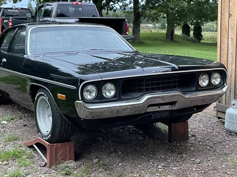

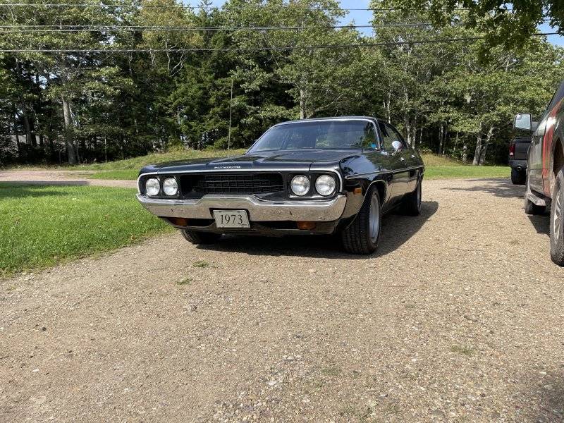

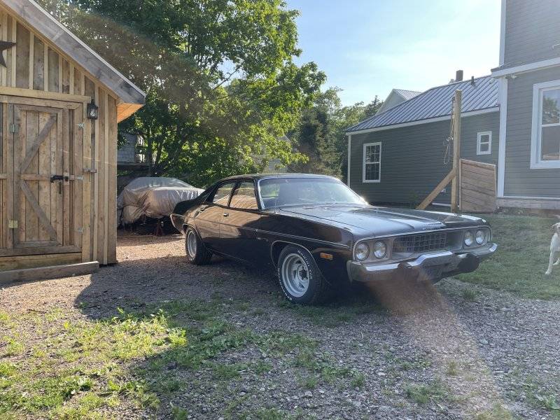

Hey folks,
I'm brand new to this and i'm hoping someone might know something for me.
I have a 73 satellite 4 door, and i plan to take the slant and the 3 speed auto (904 i think) out of it and use a 4.7L from a 2001 Dakota (4wd). I've already discovered that i need either a 2wd tranny or switch the tail section on the trany removing the transfer case. I plan on using the factory 7 1/4 and possibly modifying the drivshaft or making a new one at a local shop.
I havent actually started yet but my first question is engine and trany mounts. Is there some place i could find them pre-made or would mounts from a different engine work? Or will my original K frame work for me.
I'm not looking for big power or anything, just a nice street cruiser. Any info would help.

Sweet car, my first was also 73 4door ex-state patrol interceptor ( totally worn out in every way 400/4bbl ). Its non stop failures forced me to become a mechanic! /6 does have potential and the weirdo factor would add a certain charm in this "everything has a LS or hemi " swap world
