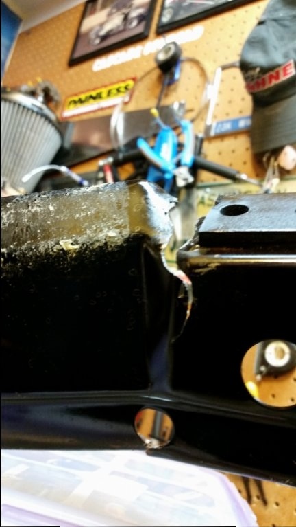

I have and issue with the seats I took them out to see why the drivers back part of the seat leans back farther than the passenger side. The only thing I can see is maybe the latch is worn out and has slop in it .I tried shimming the spring stop and it didnt change a thing.
If you take the cover off I think you will find its broken and probably need a couple of tack welds
Yep, most likely one of the sides' attachment points has broken and needs to be welded or replaced.

My 73 SE drivers seat also had split the inner frame about 20 years ago. A little weld and is still good today. No more leaning back
Yep you guys were right both sides I'll have my friend weld it up tomorrow.

Damn. That's a heck of a crack...can't remember ever seeing that in a seat frame before (I have/had at least 6 sets of 70's B/E seat frames).
Both sides were cracked big time and on the bottom left corner also.
