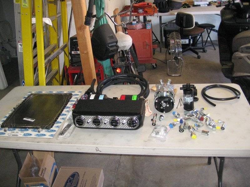

So my Vintage Air kit came in about a week ago.I must apologize for the crappy photos.
But this is it. Total cost from Speedway Motors including Nevada sales tax is $1023.05

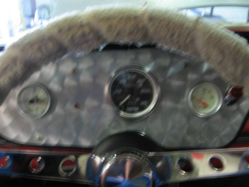

Got the engine turned face to match my homemade dash gauge cluster.Large assortment of fittings to make up the hoses.
My buddy has a crimping tool I can borrow to make up the hoses.Both A/C and heater.
Again sorry for the crappy photos.Camera man (Me) didn't know what he was doing:mad:
