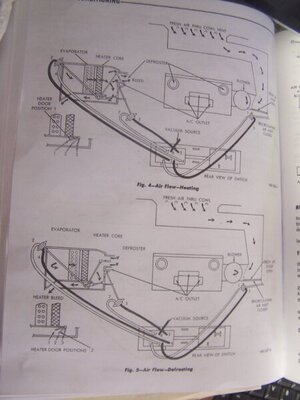

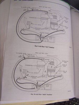

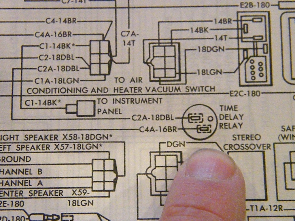

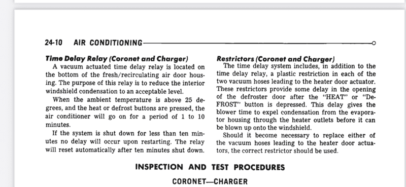

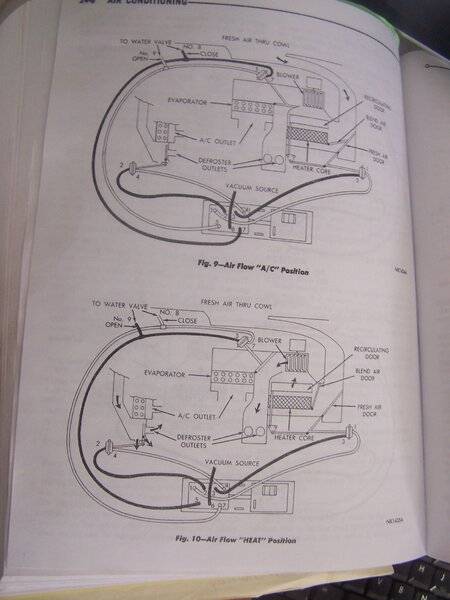

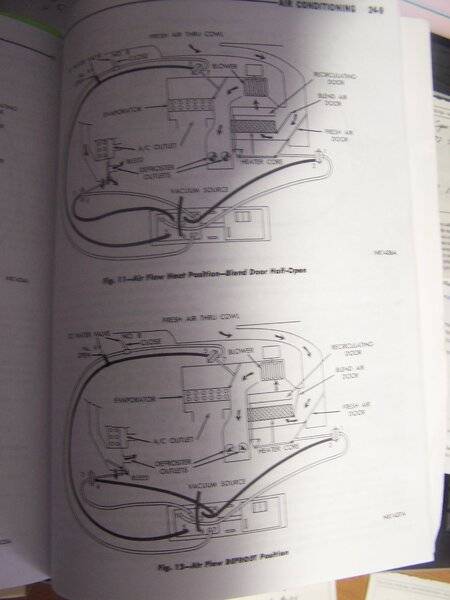

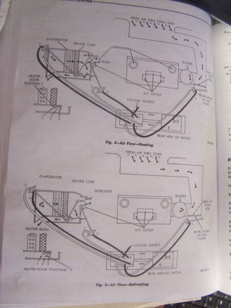

The a/c is working, although when I checked it late last summer, it seemed to be not as cold as it should be. Someone has monkeyed with this system before and I believe that i have everything hooked up properly now, with the only question being the vacuum hose on the delay. In spite of the red stripe on the short hose, is the vacuum line from the relay going to the right spot?
