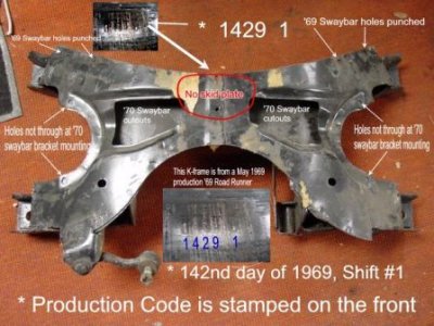

From another A12 owner.
That is good descriptive picture, however keep in mind that it is not an A12 SPECIFIC K member, it is the same one used for ANY V8 after a certain date that began around the time that the A12s began production.
