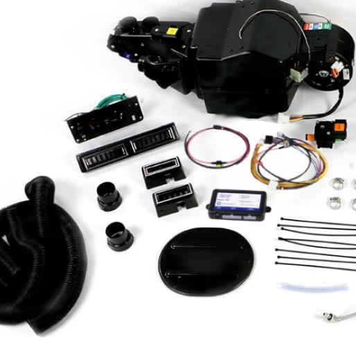

What is this dash vent panel shown with the Vintage Air Challenger kit -
I know it's a stretch, but if Chrysler used the same factory vent panel on Challengers as on Chargers, than perhaps one of these Vintage Air Challenger kits would send air to the dash vents on a Charger (instead under the dash). That would make Vintage Air my top choice, but is it true?
Well, I may have got my hopes up for nothing - but other pics show individual vents, not the bar that looks like the factory vent bar in the dash.
I assume the tubes that look like a shop vac hose go from the HVAC box to the vents - it seems like the vents could be mounted in the factory location although it would take some custom parts fabrication.
How did the factory get the air from the HVAC box to the dash vents? Maybe this is as easy as coming up with a coupler between the aftermarket hose and the factory duct.
