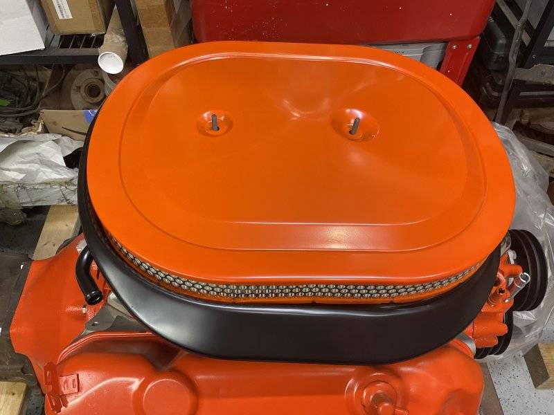

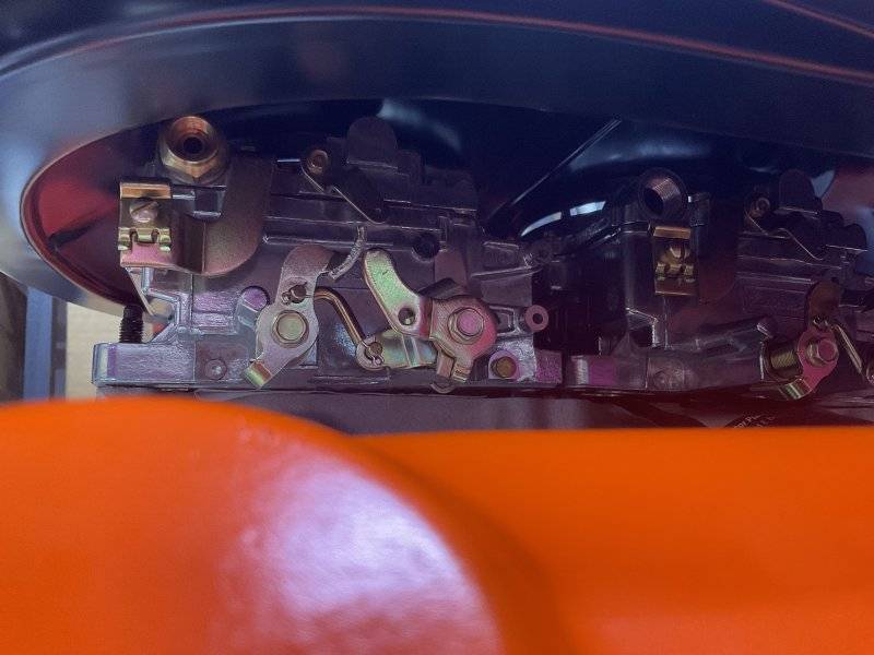

Good Day Everyone. I have a 71 Charger with Ram Charger hood. I am running an RB engine with the Edelbrock 440 dual carb intake and Edelbrock 1405 carbs. I bought the dual carb air cleaner from Tommy the Chryco and everything fits except it looks like its tight underneath the base plate where the fuel lines will install on the carbs. This is the air cleaner that Edelbrock stated I need for my dual carbs and intake to keep a factory appearance with N96 system.
If I need to install air cleaner spacers on top of the carbs, how much space do I have to raise the air cleaner within the air box beneath the hood? I thought I read somewhere there was 2” of forgiveness above the air cleaner lid normally? Im thinking I only need, at most, 1” of height to have room for the fuel lines. Thanks!

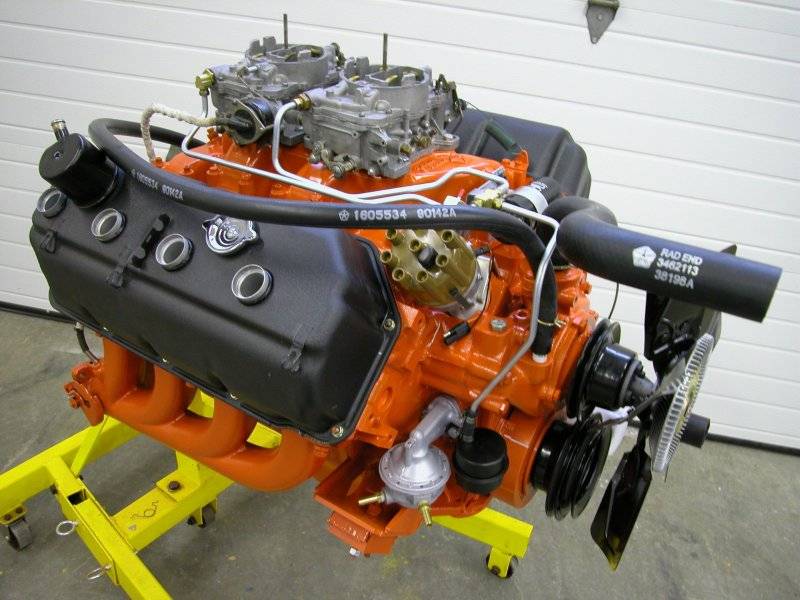

Get a carb inlet fitting from a 426 Hemi rear carb and the aircleaner can stay where it is. The problem with raising the aircleaner is not the lid it is the angled seal surface on the base to the seal on the air grabber.
Thanks. I looked at that at Mega Parts. Out of stock. However I think fittings for Carter carbs are slightly different then my Edelbrocks. I need 5/8-20 thread with a 90 that accepts 5/16 hemi carb lines. Ill just keep searching as our hardware availability here has almost disappeared. Everything has to be ordered online. I have a 90 brass fitting, so Im just looking for that piece youre mentioning to mate up and should be golden!
