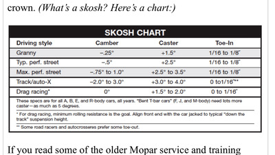

Here's what I used! Got it from allpar I believe
I use the specs you posted at stock ride height.
