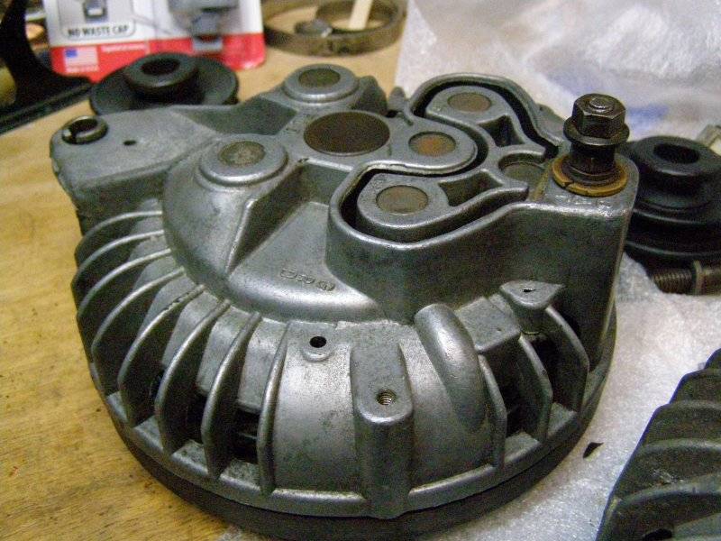

what is the correct installation depth of the rear bearing on a roundback alternator ? Should it sit flush to the rear case ?
Pic 1 is current alternator where bearing sticks out about 3/32 from rear case

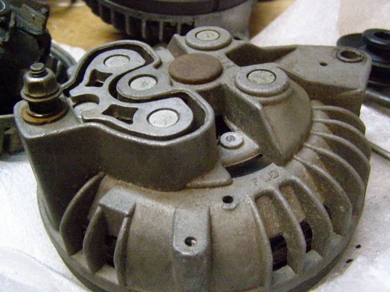

Pic 2 shows inside of rear case where bearing is flush to inner case

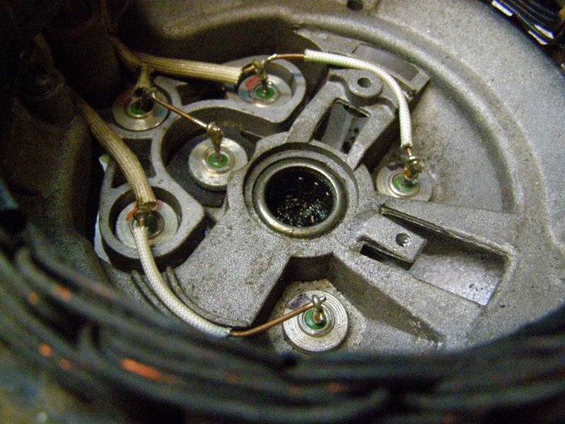

Pic 3 is previous alternator where bearing is flush to rear of case
I dont want to hammer the bearing in any unless necessary. The unit spins freely and the bearings seem tight

I've always PRESSED in the bearing flush with the case. IMO.....NEVER HAMMER THE BEARING...press it in while supporting the case to prevent damage to the case. Caged needle roller bearings are delecate. In addition, I always add a small dab of synthetic grease to the bearing's rollers, when reassembling the alternator.

Also note the plastic shield on the end of the rotor which keeps grease from leaving the rear bearing area-it covers the bearing extending past the inside of the case. Another clue!
