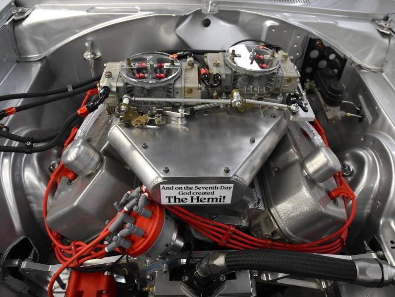

Just curious what the thoughts were regarding aluminum fuel lines mostly in regards to today's fuels? I'm getting ready to replumb my fuel system and really don't like the idea of running any form of hose from front to back for the simple fact that you have to fasten it down so frequently to get a nice clean result. After looking at options it appears all of the AN to tubing adapter fittings are made for aluminum tubing, no stainless options. My car has had a 3/8" aluminum fuel line on it since I built it (19,000 miles) BUT I haven't had it off yet to see how it looks inside so... Just wasn't sure since steel in a no no with ethanol and I know aluminum corrodes.
I've had a 1/2 aluminum line on my car for 20 years, no complaints. I just bought another coil of 1/2" to replace about ten feet of -6 braided line (edit: on a different car) that leaks like a sprinkler fountain. Using a/n adapters on both ends.

Probably the best stuff you can use. The problem with today's fuels is the alcohol, ethanol or methanol content. These are very corrosive and attack metal. Plain, uncoated steel would hold up the worst. Stainless would be the best. The problem with stainless though is that its very hard and is not easily flaired and even when it is its so hard it doesn't conform or crush easily to form a seal. I'd probably stick with aluminum. The companies making aluminum fuel line know the issues and are probably coating it inside to prevent corrosion.

I've run aluminum fuel line for 20+ years without any issue at all. Stainless steel would work too, but is harder to work with, more expensive and doesn't offer any benefits over aluminum as far as I can tell

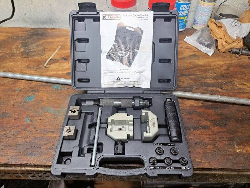

I bought stainless for my 1970 Cadillac and my 1977 Grand Prix. One of the Cadillac fittings was wrong, so I had to cut the line, take the fitting from the old line and install it on the new line. The only problem was that my Harbor Freight flaring tool didn't have the balls to flare SS lines. I had to buy a more expensive flaring tool that could handle SS, but I'll have it for life, and the Cadillac has new SS brake lines that don't leak.
