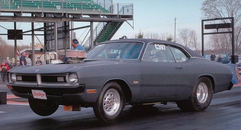

Good question.... but mines never been dyno-ed. So, mathematically it came out to about 680 hp I thought and I dunno the torque. Stock 400 block, indy 440-1 max wedge heads and square intake with Dominator adapter (for better signal), Eagle crank and rods, Wiseco flat tops with reliefs, Ultradyne solid roller cam. Ran 10.0 @ 140mph (too high mph), no tuning or power adders in a 3200# max auto car with a brake. HTH, Lefty71View attachment 666315

I'll dig them out and repost..... HERES THE EDIT;
Ultradyne R72/R72
Grind # 308R8
Dur. @ 50 276/276
Straight pattern cam, solid roller grind
Lobe lift .4567"
Lobe Separation 108
Seat duration @ .020 308
Gross Lift .686"
Hot Lash .026"
Degree to 102 ATDC
I was told stick with 1.5 rockers, and I think we used K Motion K-950 springs with this cam. I was also told, torque peak was ~ 3,800-4,000, power curve was 3,950 to 4,000 in range, and 7,000 was max 6,500 more useful.
I do know although the car ran 10 flat, with small changes to the rev limiter it will hop right into the 9's, and I never experimented much further....
